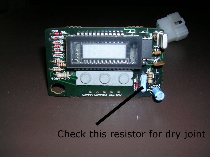

hey for all you guys out there with l's and stuff clock if you have a soldering iron they are esay fix, for some reason son of the solder on the capacitors go dry and the clock display will fade in and out, pull the cold out oull it apart and re solder the joints and it should work again, dit this to a few i had and they worked ever since....

:mad: I have resoldered the wires to it, replaced a resistor, and the thing is still playing up..........must be full of dry joints, last time i broke the clips too:mad:

I haven't removed mine yet, but if there are any electrolytic capacitors on the board, try replacing them too. They are notorious for drying out.

Post by r00fi » Fri Feb 09, 2007 11:07 am
Clock fix
This resistor is in the supply (probably for a Zener diode) and gets hot.
Eventually leads to solder failure.
Resoldered and is now perfect....

Post by Alex » Fri Feb 09, 2007 11:19 am
what are the specs of that resistor? mine is fully stuffed!

Post by r00fi » Fri Feb 09, 2007 1:01 pm
I have a high res version of the pic but can't read the exact ohm value written on the pcb. It's definately 2 Watt, and has 820J stamped on the resistor (820 ohm???). You could try a 1K 2W or maybe someone has a clock laying around the garage that they read the value from?
