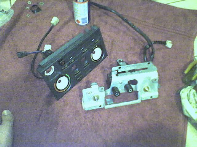

This is what I did :
Old one is on the right - it was corroded & not working ... :( ... Add : It's the same Tap !
Add : Taken from here : Bantum's Brumby
Tip - The other thing you should do is free up the cable & dial switch in the dash ...

Post by steptoe » Fri Oct 25, 2013 4:01 pm
:( Paul forgot to link or suggest what "these" are, and the rooster tells us the old one is on the right...so , what is the one on the left???

Post by Bantum » Fri Oct 25, 2013 5:36 pm
Yeah - You'd have to take another gander at what's behind there, as you might have to fit a relay switch of some sort if you want to convert to electric ...
Sorry I don't have a picture of other ( back ) side ... :(
P.S. - In the previous photo above - it's the same item, you're just looking at it from different angles ! ...
Ciao, Bantum ...

steptoe wrote::( Paul forgot to link or suggest what "these" are, and the rooster tells us the old one is on the right...so , what is the one on the left???
Negative ghost rider.. look at the ebay link in post #3
