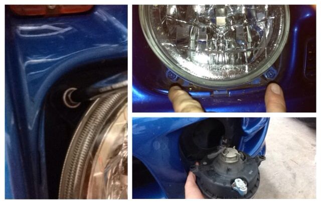

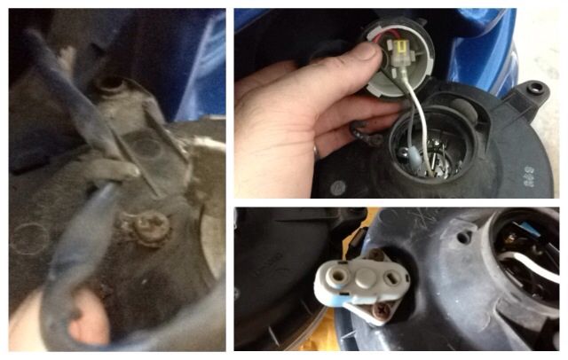

Remove 3x m6 bolts, swing Light out to access wiring...

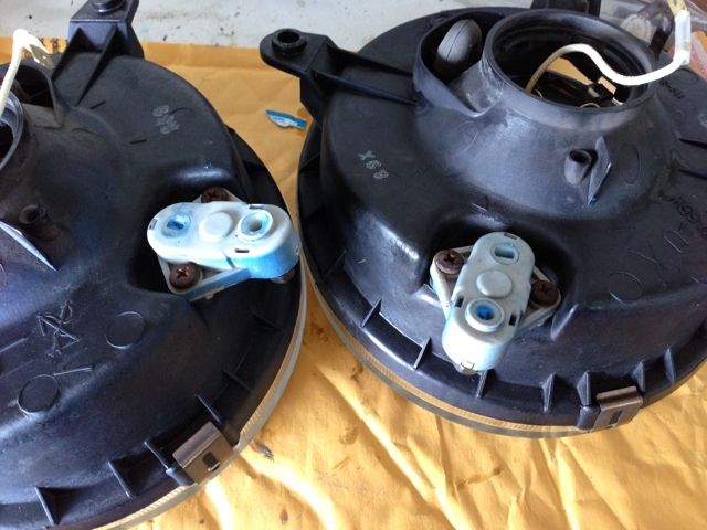

Unclip cable from side, turn & remove back cap, disconnect the H3 wiring and the Light is out. Remove the adjuster gear ass'y with 2x phillips head screws...

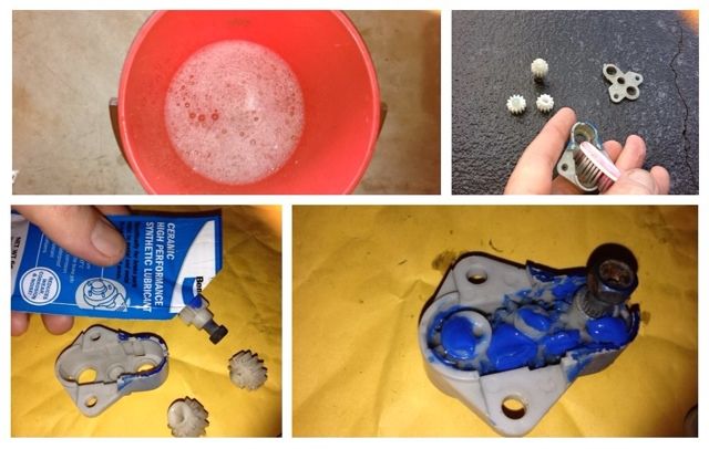

Flick the cover off the gear ass'y, put it a bucket of nice warm soapy water, clean all parts with a toothbrush, dry and reassemble with some plastic-friendly grease...
Refit gear ass'y cover and refit ass'y to light, refit light.
