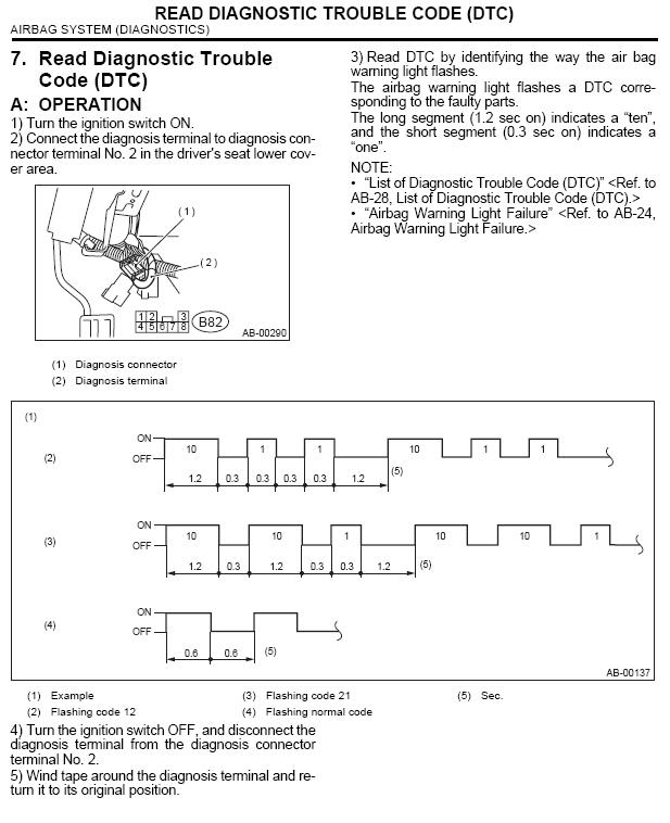

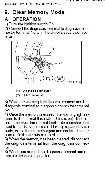

Post by Gannon » Fri Mar 08, 2013 4:35 pm
airbag diagnostics2.JPG (47.53 KiB) Viewed 4375 times
airbag diagnostics.JPG (76.73 KiB) Viewed 4375 times

That vid was wrong Alex, there is no plug like that.
Gannon I don't see any connector or loose terminal like that. Does your Outback have it, I have even removed the fuse box from the OB.

Post by Gannon » Fri Mar 08, 2013 7:33 pm
Found it along side the ECU test connectors sorta above my right shin, just below the TCU

Post by taza » Fri Mar 08, 2013 11:46 pm
I see those two white plugs. I have tried both of them and earthing them out with no success.
