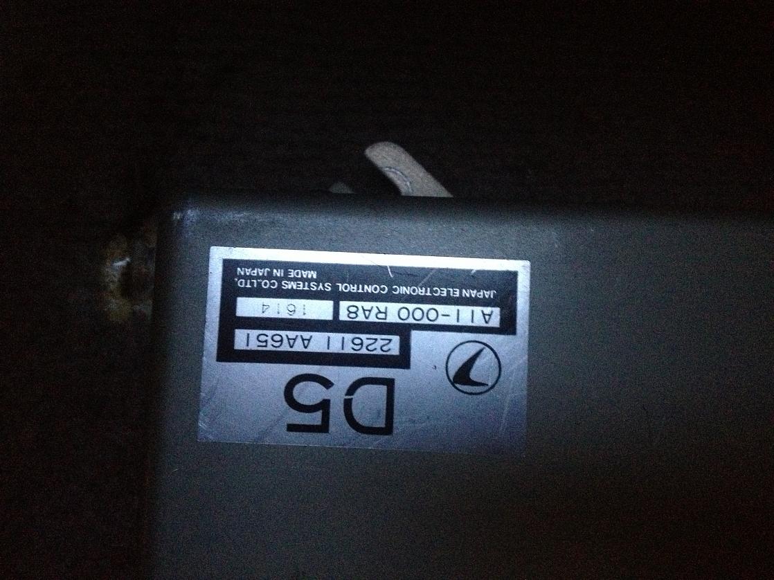

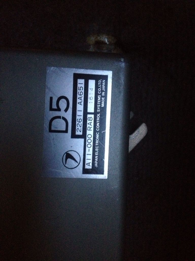

Likely to help if you can ID the ECU in use, and/or what you got the donor bits from....first
Post by steptoe » Mon Dec 17, 2012 7:23 am
oh, and photos please :)

Post by tony_de_whitt » Mon Dec 17, 2012 7:48 am
Ha ha.
Yes I'm sure that info would help a lot.
Sorry
Will get the info later and put some pics up aswell
Cheers ant

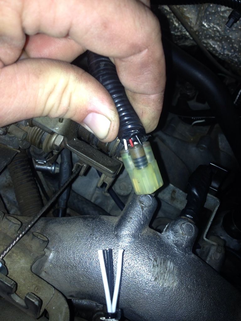

So my question is
Which of the 3 wires
Red black and white is the live? Which I will connect to the live on my new sensor.
And what do I do with the other 2?
Post by steptoe » Mon Dec 17, 2012 10:28 am
Gannon was good on his O2 sensor going from one wire to four wire ...wait until h chimes in.....
Post by Gannon » Mon Dec 17, 2012 10:50 am
On the loom, red and black are the heater supply and the white is the signal.
On the sensor, the 2 whites are the heater supply, connect them to the black and red of the loom, not polarity sensitive, the black is the sensor wire, connect it to the white on the loom.

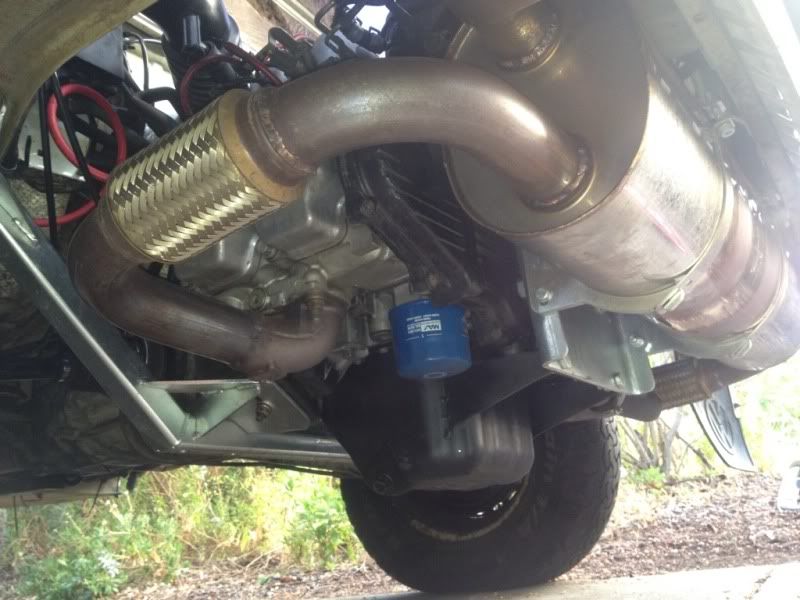

tony_de_whitt wrote:
G'day,
Im interested to look at more photos of it, i love the brackets and supports for the engine & muffler.
Would the timing belt cover cope ok with the muffler there or you have heat resistance?
Post by NachaLuva » Tue Dec 18, 2012 11:46 am
Yeah great install isnt it.
I wonder if a SS heat shield might be in order...
Posts: 2040
Post by Bantum » Tue Dec 18, 2012 1:14 pm
Do you have plans for a Sump Guard ? looks a bit low to me ...
