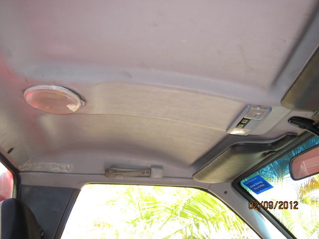

they look pretty good, could you get us a photo of what it looks like when its in your car?

Nice, what are the two lights on the left for?
Puddle lights in the door Im guessing.

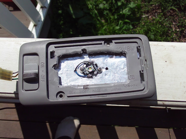

I did it in my Outback a few years ago, but discovered that some LED panels are designed for 12V and dont last very long on 13.8V when the car is running.
I have since converted to 1x3W Cree LED that is driven by a constant current driver so voltage fluctuations dont affect it
I'll get some photos if I can find then

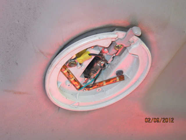

Ok - for the first lot, here is what come's in the kit :
Note : As there are various adaptors & connectors for the light, chose one that best suits ...
Firstly carefully take apart the light ( Watch out for the spring loaded ball bearing ! ) then put the adaptor in ...
Add : Also take the opportunity while you have it apart to clean-up & fix any binding / broken bits.
Notes : I've cut out a bit from the back to make it fit as it can be a bit fiddly trying to get it in.
Also the adaptor has a resistor inside to maintain correct amps ... :wink:
Then Install the light istelf ...
Note : I've used the existing holder, just bent it a bit to make sure it holds ...
Then hook it up to existing ...
Note : Testing here to make sure it all works + also make sure that the screw fixing completes earth circuit ... :!:
Finally put the light cover back on ...
& Presto - Done ... :D

Post by Gannon » Mon Sep 03, 2012 6:21 pm
Bantum wrote: Do tell us more ... :?:
Well I started out with this
Which worked too well and was like having a highbay light in the car and was way too bright.
The issue was that after about a month, individual dies (the LED chips) started to flicker and die. On closer inspection, the normally yellow centre had turned brown and this is because they were driven with too much current and they had burnt out. I put this down to poor design as the current limiting resistors were 47 ohms which gives 50ma at 12v, but it should have been 100 ohm resistors for the normal 14v car voltage.
So I went in another direction....
I got a 3W Cree star emitter and a constant current driver, which keeps the current at a constant 350mA irrespective of the supply voltage.
Being a large 3W device it needed some means of dissipating heat, so I grafted a aftermarket cd player heatsink into the interior light and the result was...
I also put one in the boot light and made a heatsink using some alloy angle
I'll go get a shot of it in the car after I've fed the boy
