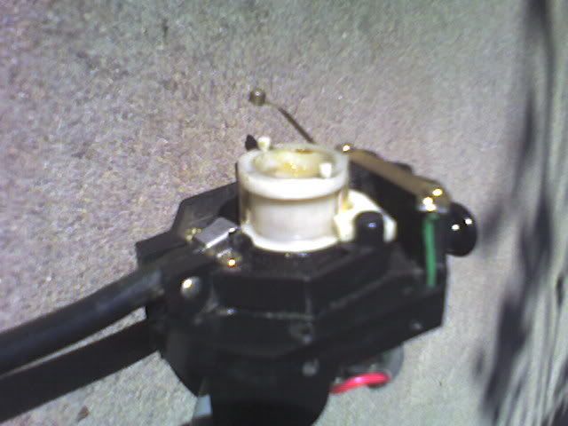

Firstly take the usual steps to remove said offender ... ( I'll be using the Brumby as an example - I'm sure it's similar for other peroid models )
This is the offender ... ( you may be able to see that a 'groove' has formed from where the return hits )
Note: Appologies for image quality, as I did this with a mobile phone some time ago ...
Update :
A bit more clearer shot showing the damage - thanks to auster ...
Cheers, Bantum ...

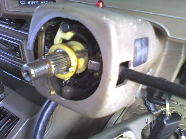

Ok - now if your happy with it, put it all back together ...
Add : Don't forget the spring ... !
Note: Just make sure the little raised sections on the end ( spigots ) engages the holes on back of steering wheel / shaft.

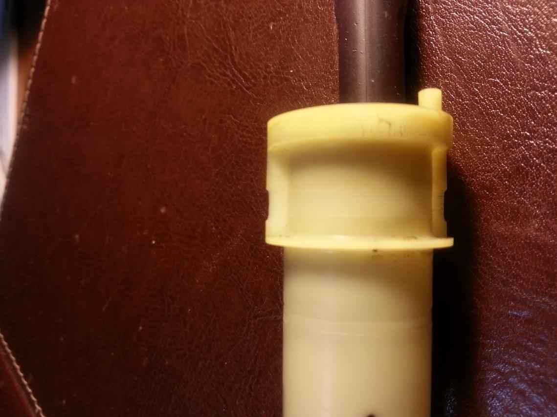

I have just applied a variation to your fix to my 1987 Brumby. The turn indicators stopped self cancelling. On dismantling it was, as you suggested, that a groove had been worn in peaks of the plastic cylinder which catch the pawl to cancel the lamp.

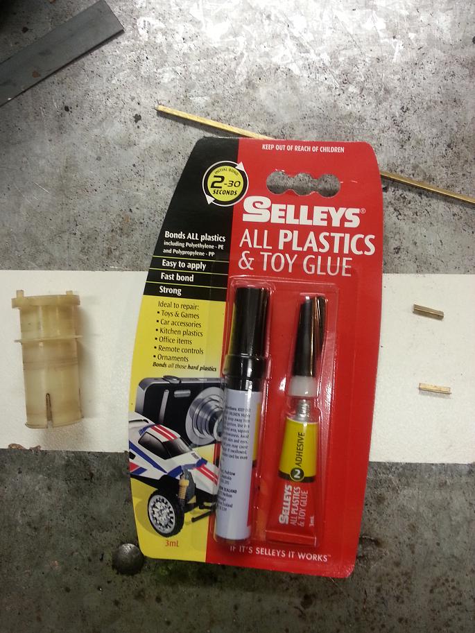

I bought a 300mm length of 3mm brass angle for $18!!!. The only difference was that I glued it to the cylinder. It was not clear to me why melting the plastic would provide adhesion. I used Selley's plastic glue which is supposed to stick any plastic including PE, PVE and PVC to metal.
We will have to see how long it lasts.

This post is to be read as part of Bantum's post and mine on doctoring the turn indicators. Mine are still going OK. When I glued the angle onto the cylinder it was about 1mm proud. But it does not foul the system and so far works well. I have enclosed a picture which clearly shows the groove worn in the cylinderhttp://www.ausubaru.com.au/images/attach/jpg.gif. Bantum's pic was a bit out of focus.
This is the glue I usedhttp://www.ausubaru.com.au/attachment.php?atta ... 1394695103
