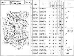

Post by steptoe » Sun Mar 25, 2012 11:54 am
Does anyone know what this is
Uploaded with ImageShack.us, its function etc ?
Found it on my 89 mpfi wagon I wrecked, think the Vortex also has one in same place RHS strut tower at the front, inside is a white ceramic housing like a coils resistor
Post by RSR 555 » Sun Mar 25, 2012 6:28 pm
Resistor.. check wiring loom for details of what it connects to. I think it is for the coil??

Post by LT65 » Sun Mar 25, 2012 6:55 pm
If its from a MPFI would take a good guess at it being the dropping resistor for the injectors.

Post by steptoe » Sun Mar 25, 2012 8:27 pm
Hmm, coil is LHS this is far right ..... resistor sounds good to me :) need wiring diagram or study the parts manual

Post by spambo » Sun Mar 25, 2012 9:32 pm
yep dropping resistor for the injectors 100%

Post by El_Freddo » Sun Mar 25, 2012 10:47 pm
The unused clip for a relay or solenoid is for the turbo models...
All MPFI have this thingy what ever it is, I've never really looked into it too far.
Post by RSR 555 » Sun Mar 25, 2012 10:59 pm
I'm going with dropping resistor for the injectors.. makes me wonder if they have the same in the EJ.. can't remember seeing one :-?
Post by Gannon » Mon Mar 26, 2012 5:20 am
Yeah yas have pretty much hit the nail on the head, its the dropping resistor for the injectors because they are low impedance injectors (2 - 3 ohms). The clip on the end holds the boost sensor for the turbo light on the dash.
EJ injectors and pretty much most cars made since around 1990 have high impedance injectors (12 - 14 ohms). Interestingly, the XT6 had high impedance injectrors

Post by steptoe » Mon Mar 26, 2012 8:05 am
Yeah , could be a good explain. My 85 made, 87 compliance plated GLTA does not have one so injectors not interchangeable ???
Post by Gannon » Mon Mar 26, 2012 6:05 pm
Mmmm interesting.
Its possible that 85-86 ECU's used high current driver transistors, and in 87, they decided it was more cost effective to use smaller transistors and a resistor
