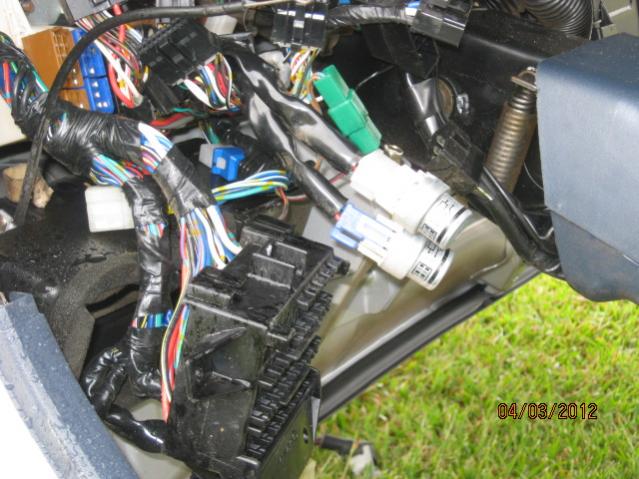

Can anyone tell me where the L series lighting relay is located and what it looks like. I am guessing it may be up under the dash above the fuse box.

thats right, under the drivers dash, canister looking things.
They do get rather very warm.
Why do all these heavy current carrying wires need to come out to the dash and then back to the front of the car ?.......re-wiring is a major job though.

think this is them or they are the same anyway.
