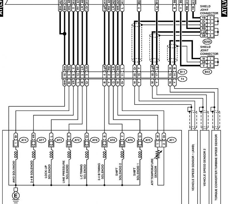

My speed sensor on the gearbox has died so i got a another one from the wreckers
Now the problem when i got it home my one is a 2 pin the one from the wreckers is 3 pin:???:
Can i use the 3 pin one on my car but leaving one wire off or is there a trick to it or did i wast my money:(
There were 4 foresters there and all were 3 pin 1999-2001 you wouldn't think they would change something like that
Please help
Jan
Post by Gannon » Fri Jan 06, 2012 5:56 pm
The sensors are all 2 wire devices, yellow being the signal and white is connected to ground/negative. the 3rd wire you have is a shield and is joined to the white ground wire. You could probably leave is disconnected
