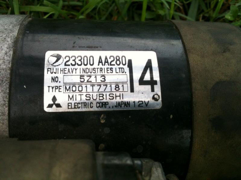

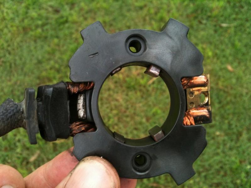

Tested the spare L series starter with battery and jumper leads, works. Did the same with the Lib one. Started once, then dead. But I can feel the solenoid attempting or energising. Leave it for 1 beer. Same again, cranks then dead. So pulls the starter apart. Below is a pic of both the brushes and the sticker.
So Im hoping someone can tell me:
a) are the brushed stuffed? They look it to me, but not exp with brushes.
b) are they replaceable, a search says yes, but from where?
c) ball park cost? Car will be scrapped in under 12 months, need to avoid spending unnecessarily.
I'm hoping this will solve all my recent issues with starting and idling when cold.

Part sourced. Subaru part number 23379AA000 $ 40.50 ish.
I picked it up at a local auto electrical for $25, price was a bonus Im just glad he happened to have it in stock!
Post by NachaLuva » Tue Jan 31, 2012 1:27 pm
Good score ;)

So just to wrap up this thread. My initial issue appears to have been the ignition relay intermittently playing up, this gave error codes 21 and 24 (ECU temp sender and IAC Valve). 21 was related to the ignition relay, 24 I may have fried mine accidentally, starting the engine (or attempting to, cant remember) without the ground cable installed, woops my bad. Picked up a used wrecker one for $45, but it too was still not functioning correctly (and continued to give code 24) due to the ignition relay issue I guess. I also managed to fry my original Temp sender unit testing by putting 12v through it when it should only see 5v from the ECU. (pays to read the manual first). Again one sourced from the wrecker ($10?). So at this point I was getting rather frustrated and started looking deeper and thats when I found Talasas's thread on the ignition relay. Picked up a used one at the wrecker ($10?) but it didn't improve anything. Ordered the Bosch relays (took about 4 weeks to get them, thats another story), finally got them a few days ago. Did the relay mod, dead, no click no nothing, just the dash lights dimming as the key hits the "start". Turned out my starter brushes were cactus, managed to get a replacement ($25) the next day (nice when things just work out). Installed the starter motor again, started first go. BUT it started on the wrecker ignition relay. Have not yet tested my original one or the Talasas's mod one yet. Why did I do that, no idea. And why didn't it work the first time, also no idea. Can only assume its playing up too, but has been fine the last two starts, time will tell.
