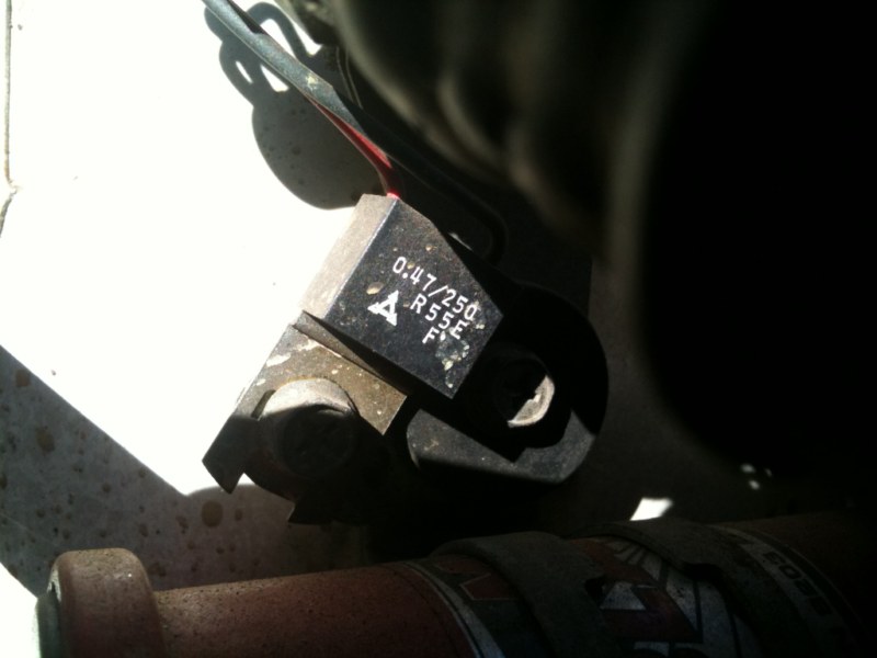

Anyone know what this is and just as importantly how/where it should be connected to? Im assuming its air con related. Capacitor perhaps.
Located above the coil and under the Radiator reservoir tank.

Does it have a plug on it?
The markings on it suggest it may be capacitor, but not sure if it is aircon related. More likely to be connected across the coil

Cap for RF noise suppression

How do I connect it? I assume its needed?
It has "O" ends that would fit on the coil, positive is possibly too large and may better connect direct to the battery.

Unless you a whine coming over the radio, don't worry about it!
