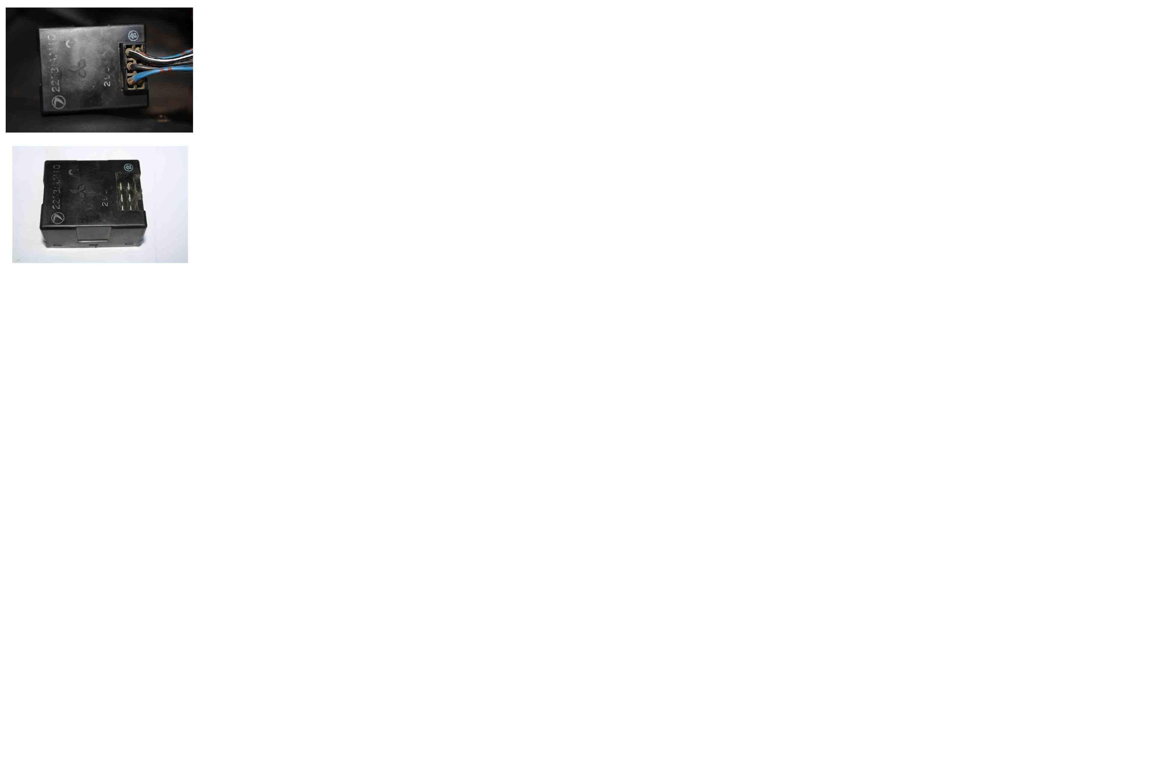

Its a little 50mm by 50mm black box that hides on firewall above the fuse box under the dash. Correct about nil stock , At least 2 weeks to come from Japan.
Post by steptoe » Mon May 09, 2011 3:55 pm
can you do a photo to save me crickin' my neck. I may have one not in use.
Number of connector pins ? Wire colours ?
Has it got the part number on it?
warrenel4
Posts: 11
Joined: Mon Apr 05, 2010 5:38 pm
Location: wa
Post by warrenel4 » Mon May 09, 2011 6:51 pm
Part number is written on top of box 22631AA100 [ATTACH]2688[/ATTACH]
Post by steptoe » Mon May 09, 2011 6:59 pm
OK, never seen one of these in my travels. I wonder if it is pre 84 component, as mine is 10/84 Brumby. Also parted out 3/84 sedan. Come to think of things, mine was supposed to have some sort of fuel cut solenoid in the carby, but was more pollution than safety I am certain. I am of no help to you on this, sorry, but thanks for the pics, does help !
