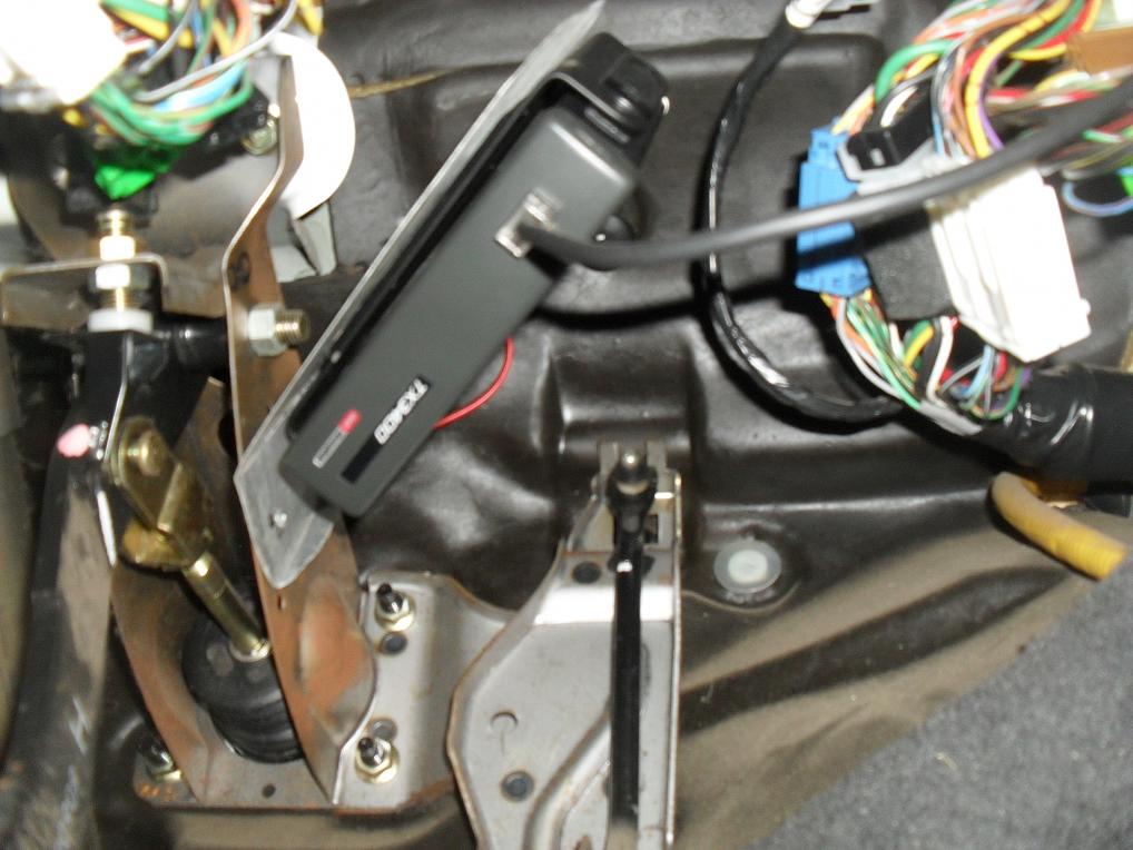

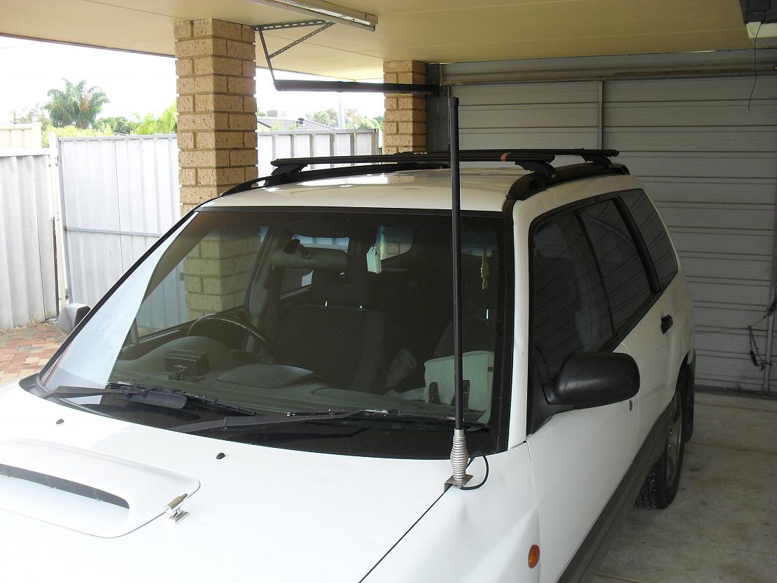

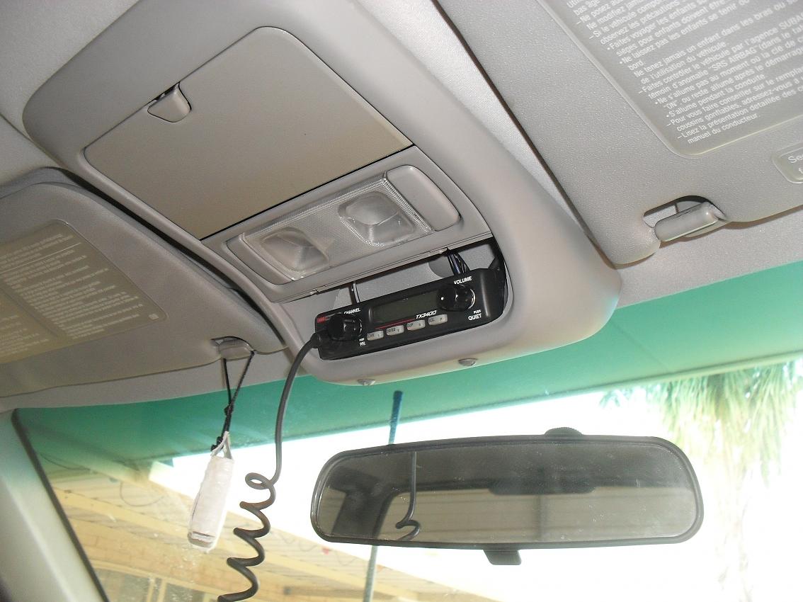

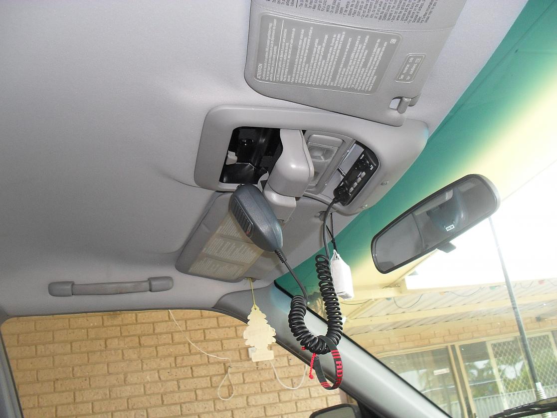

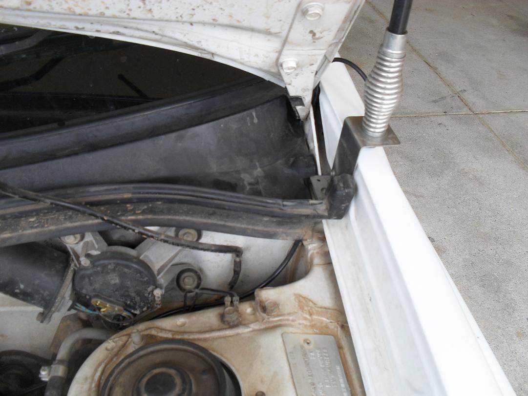

here's how i installed a remote head UHF in my 99 GT forester
mounted the aerial passenger side of bonnet near hinge point, on a Z mount,
mounted main unit (with in built speaker) above pedal configuration next to steering column,
mounted the hand piece and and head unit up in the roof console where the little clock used to be,
