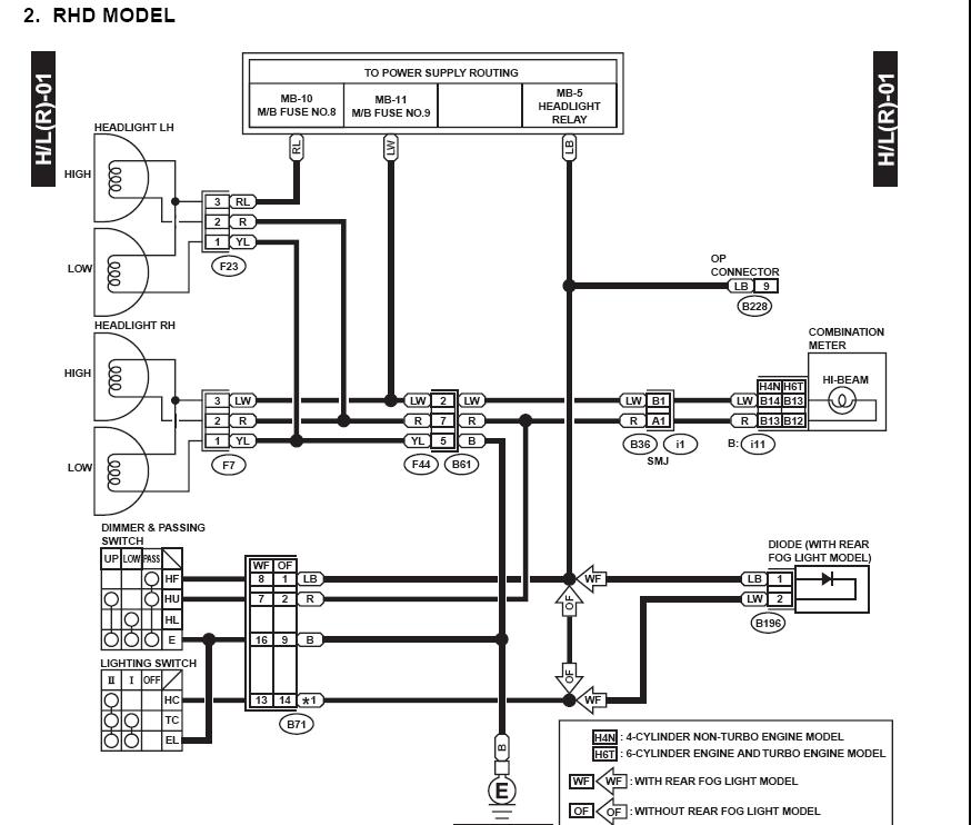

hi all,
just chucked my lightforces on the liberty for abit of touring ill be doing soon.
got them all working fine, but i cant seem to get them to work with my highbeam/find the highbeam wire in the stalk.
anyone know what colour wire the high beam is?
also is my car negatively switched?
cheers

this may help and yes 99% sure yours is earth switched, took me ages to get my head around it ..... not sure i totally understand it still!

Looks like its the red wire that you are after
GenIII Headlights.JPG (80.99 KiB) Viewed 2291 times

I've since updated my five year old drawing that is found in the above link from FROG:
Just make sure the source of the power for the on dash switch is something that turns on and off with the *IGNITION* - otherwise you'll have to turn the dash switch off when ever you turn the lights off or you'll be driving around with your driving lights on without the standard lights being on...
Hope that makes some sense.

Pretty sure I used the red wire, but found it at the back of the headlight, rather than in the stalk.

my gen 1's wiring didn't match the workshop manual... so I pulled the headlight switch out and probed for the highbeam from there, then followed it into the harness connector, and then the colour was consistent from there... I think L one was green and R one was red... either way, I spliced the switch in from before the harness and it works fine.
A tip bennie gave me, make sure your fuse is as close to the battery as possible. The harness that came with my Roo Lites had the fuse right next to the relay. I'm adding an additional fuse in when I transfer the wiring accross to Libby.

I realised yesterday that I was wrong, you need to source the dash switch power from the ignition as per the diagram...
