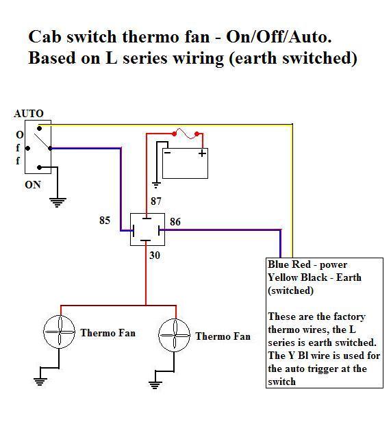

This is how I've got my fan override set up:
Pretty sure the fan wire out of my ECU (96 EJ18 Impreza) was red/green. Newer ECUs have two independently switched fans, which gets more interesting.

If that's how you've wired them in. I don't know of two sensors in the L radiator, only one in a standard radiator... I've got my only thermo fan wired in like this:
When I get a second thermo sorted I'll have the auto side of this triggered by the ECU, so I"ll have one fan from the temp of the radiator and one from the ECU. It'll be interesting to see the difference in switching of each fan in different conditions.

The diagram with the thermo fans, how would I wire up a 2nd fan (nothing fancy like different speeds or anything) Would i need a 2nd relay?

is it ok to wire up two fans like this using a single relay?

No that won't work, you've got earth to both side of the switching part of the relay. Also ideally they run a relay for each thermo due to the current draw. Why not just copy whats there? Its got 2 relays switched by the computer. Then you still have hi and lo and if you connect up the air con it will be turned on by the computer. Why do u want a switch?

drof351 wrote:No that won't work, you've got earth to both side of the switching part of the relay. Also ideally they run a relay for each thermo due to the current draw. Why not just copy whats there? Its got 2 relays switched by the computer. Then you still have hi and lo and if you connect up the air con it will be turned on by the computer. Why do u want a switch?
It will work, it's just that the diagram is a bit confusing with the yellow/black and blue/red wires disappearing into a mystery box.
Blue/red needs to go to ignition positive, yellow/black goes to ECU (or fan switch in a stock L) switched earth.

Yea atm I have the ECU running the fans quite well, but would like to have a bypass switch maybe as added insurance to not give the motor a chance to heat up too much in extreme situations, I've got it basically figured out now.
