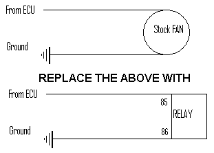

attached is what i'm trying to do. basically replace the stock electric fan with a relay. however when i do this, it's like creating a short (positive from the ecu connected straight to the ground, but through the relay) and that is why the fusable links start smoking.
i tried placing a resistor on the ground wire after the relay. the resistor i used was a 1W 1.5K, but when i did this, the relay didnt trip. should i try a lower ohm resistor? maybe try the other wire incase i thought the ground wire was actually the power wire?
the next thing i tried was placing a resistor (1W 1.5K) between the 85 and 86 pins on the relay. the fans worked, but after a test drive tonight, the fusable links still smoke - obviously no good.
what should i do???
what should i do???

This is on the L Series RX?
Or something else?
Stock fan or fans - which one(s)
Stock ECU ? Don't switch fans do they?
You'd think the positive to the relay would be straight to it through ignition and fuse and the earth was doin the switchin' (through ECU ) ECU seem to do earth switching for things, think injectors, the get pos power at ignition but ECU gives them the neg earth to make em spray.
With relays 85 is regarded as the earth pin and 86 gets the switch on power connection. Most relays will work with earth hooked up to 86 and power to 85, but when it comes to diode protected internally relays things come unstuck
85 to Earth, come in Earth - just sort of remember in my own special way

yep L RX. and it's on the stock a/c fan, although there wasnt one on my car to begin with, the plug was still there.
yeah most of the time the ecu's switch the earth on or off.
it should never matter which way you wire up the relay as the power going through the relay does nothing but go through the middle of a coil. the power going through the coil makes a small magnetic field that attracts the clicker thingie arm and then allows the power to go through the other pins. it shouldnt matter about internally resisted relays too as resistors work in either direction.
so any idea on how to fix this up? i certainly dont want the fusable links smoking once the fans turn on...

This is how I've done my thermo fan setup, works a treat:twilightprotege wrote:definately not a relay problem and i couldnt work it out. so i've gone back to a stock-style setup. 1 fan running off the stock fan wires, the other fan running off a relay switched by the first fan
The On/off/Auto switch is used for when I want the fans on or Auto for when I'm generally cruising around. The off position is for the odd occasion when I'm crossing water - don't want to have the thermo fan trying to chomp through the radiator as it starts sucking on water rather than air...
Hope this helps. You should be able to wire in the two thermos the same - either off a larger relay if needed or with two horn relays.
