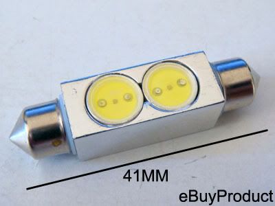

Gannon has found a pic of just what I have looked at. All the sales guy had was a sample - gauging what sort of sales he will make. Is the whole yella bit the light generator or the 2 little spots we see? The light out of one is just so great I can't look at it to see! I guess the catalogues can't kep up with the advancements. Good idea to just ask.

Curious as to whether my cheapy solar panel battery charger works, I hooked up its output to one of these wedge bulb replacement LED's and IT IS the two little circles about 1.5mm diameter that the light emits from not the whole 6 or 7 mm face. The trickle power NOT 12V of the solar unit allowed me to see this.

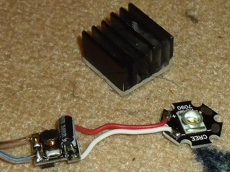

This is it CREE P4 LED Emitter
Along with this driver 1*3W 320~350mA Constant Current Regulated LED Driver
Im not replacing the festoon globe with a LED package, im placing the LED in the above picture directly over the little lens of the map light. It should then focus the light nicely. (the spacing and angle between the factory globe and lens wastes a lot of light, hence the redesign)

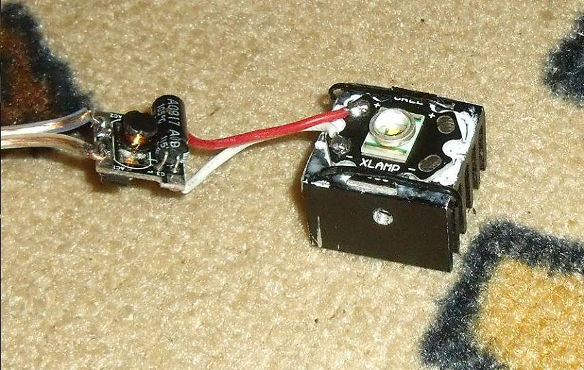

This is the 3W CREE LED and driver
The driver is a more efficient way of supplying the LED with its rated current as opposed to a resistor, which wastes loads of energy as heat.
I mounted it on a heatsink to keep it cool (LEDs dont like too much heat)

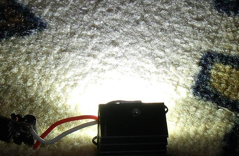

This is it on its side lighting up the rug (the camera couldnt focus on the LED directly )

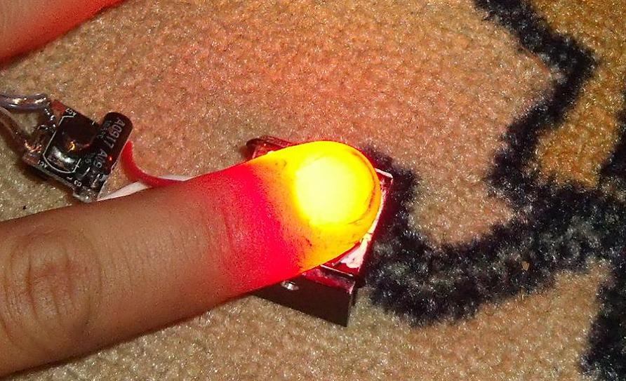

Although it looks like my finger is white hot, it is just the light shining through the flesh in the tip of my finger
