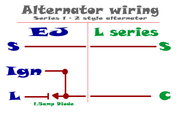

- The alternator, how do I wire this in? There are 4 wires on the round orange/red plug, the L had a grand total of 3 plugs.
- I have one ECU wire that needs to reference/go to the "C" terminal of the alternator - run a wire to the alternator for this and which is the "C" terminal?
See attached diagram. The diode you can get from the passenger side of the harness near the cruise control unit.
If you look on the alternator you will see a little sticker with S, Ign, L. Again, refer to the diagram.
