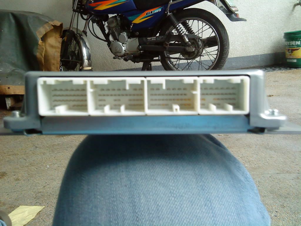

I've been looking for an ecu diagram for the 2008 impreza for months now and still haven't come up with anything
So far we've been able to figure out the most we need to install a GReddy E-manage Ultimate
The only thing were missing is the RPM pin, Throttle sensor, and Speed sensor
I'm not from Australia but I've heard that the Impreza there and here in the Philippines are the same, with an EJ204 engine (according to the user's manual)
Pics of the ECU:
Located under the floor mat of the front passenger
If anyone can confirm that it is the same? Thank You
Also because I think it'll be hard to get a complete diagram of this ecu maybe you guys can tell me a way on how to find the the certain pins we need to get the job done :D
If someone can help us. THANK YOU. I'll make a write up of the whole think once were done to help those that maybe thinking about installing a piggy

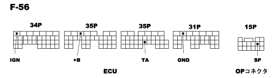

I've seen that page before, but the model I need isn't there aswell. Thanks anyway.
Anyways, We've found the speed and Tach pins only thing left is the throttle maybe if you guys know of a way how we could find it?
Mine doesn't use the cable type, its electronic thats why were having a hard time finding it
