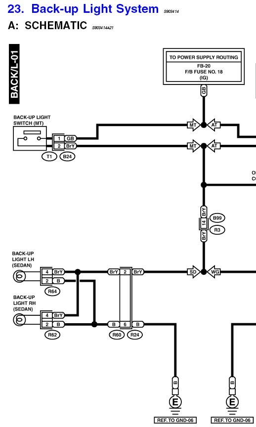

I have this prob on 98 OBW. confirmed the reverse switch on the MT is functioning by accessing the connector in the engine bay. Applying 12V with a wire to the white/red wire has the back-up/reverse lights alight. Checked every fuse in the side panel - all ok. the wire diagram doesn't show a relay....but somewhere the brown/yellow (in the engine bay) must convert to the white/red under the dash (and to the rear)........... f*****in wiring!! how much needs to be pulled apart?

Have you shorted the other side of the connector in the engine bay to check that the lights work?
Apply 12V isn't good enough as you've only checked the output of the connector, not the power supply side.

wagonist wrote:Have you shorted the other side of the connector in the engine bay to check that the lights work?
yes at the connector there is +12V and the Brown/Y wire, so I put a jumper wire on those connector pins (simulate the switch on the MT)
and there is no lights or 12V on the white/red wire to the lamps.
This is NOT the wiring I am seeing (from a pdf '98-2003 liberty)
I need to remove the dash to get at from where the wires pass thru the firewall........i tink thats the only option atm.
hate to think how much a auto-elect would charge to fix this!!
