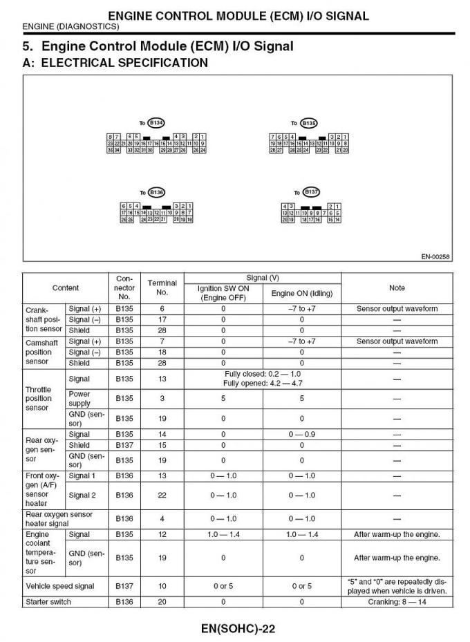

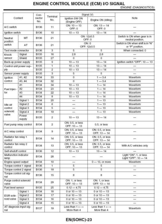

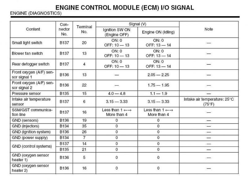

Does anyone know where I could get an ECU PINOUT DIAGRAM for an EJ25 SOHC...??????
Mine is from a 2004 Forester 5spd D/R man
Its going in my L-Series and we are in the process of wiring it up now....
Any help would be enormously helpful....!

Well Google has done wonders for me this arvo....I found a link to the below ECU PINOUT DIAGRAM for EJ25 SOHC..So here they are for any other members who could use them....
