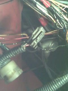

what is this connection for? pic below, i have no connection off the loom to connect to.

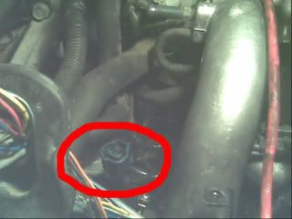

also what is this for its off the ej loom 2 wire deal there is nothing for it to connect to on the engine side, there is also a 4 wire connecton to.

Nows the problem im afraid. Something has been cut that shouldn't have been or something is now not connected. It's almost going to be impossible for anyone over the net to help you fix this one i believe.
Only thing i can suggest is to connect both the engine test mode plugs to earth and turn ignition ON. This will pulse both the ECU controlled cooling fan and the fuel pump relay on and off. This might help instead of turning the car over every time to test the pump wiring.
There is about a million places where the problem could be and with not knowing what you have and have not cut off it's impossible for us to work out what your remaining plugs should or should not be plugged in to.
