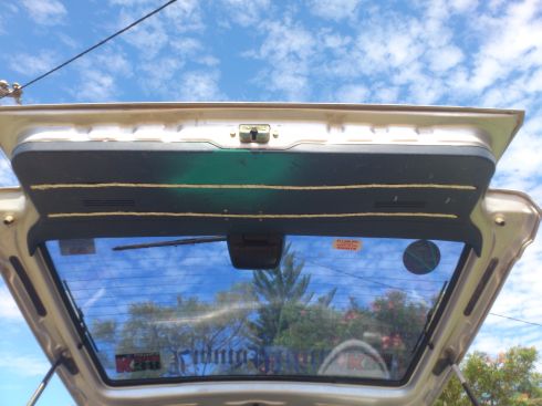

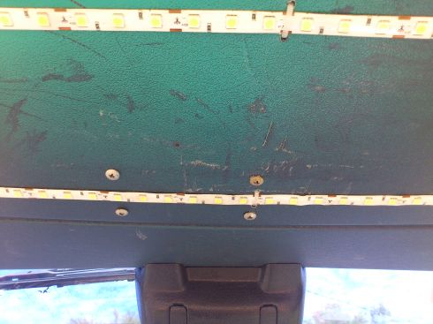

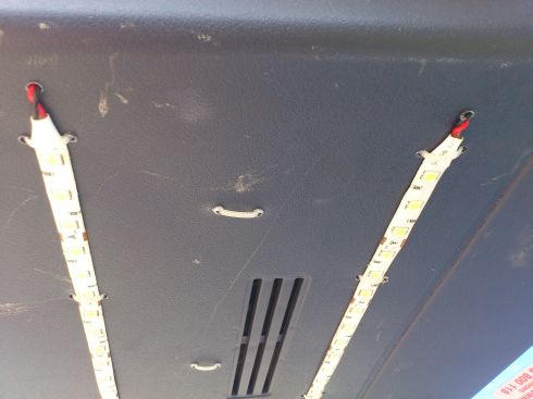

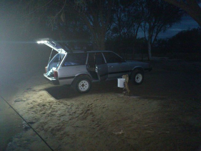

Also my rear tailgate has two rows of 5050 smd led's that are ultrabright, I disconnected my rear windscreen wiper power and hooked up a remote control on / off with dimmer to the LED strips, this makes it practical when fishing as I can control my light situation from the beach.
- 5.jpg (40.21 KiB) Viewed 41310 times
- 4.jpg (39.5 KiB) Viewed 41308 times
- 2.jpg (25.58 KiB) Viewed 41309 times
- 1.jpg (33.62 KiB) Viewed 41311 times
I can vouch for Wayne's LEDs on his tailgate, they are bright as f**kin bright.Kalbarri_baru wrote:Also my rear tailgate has two rows of 5050 smd led's that are ultrabright, I disconnected my rear windscreen wiper power and hooked up a remote control on / off with dimmer to the LED strips, this makes it practical when fishing as I can control my light situation from the beach.

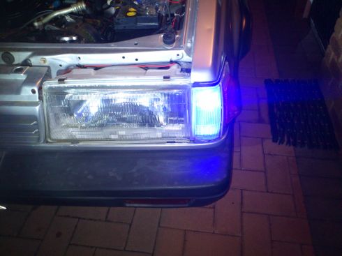

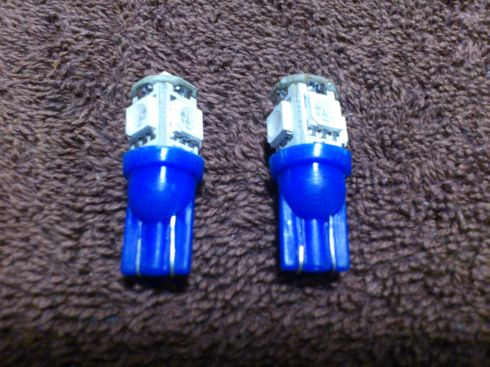

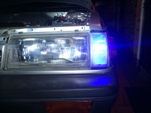

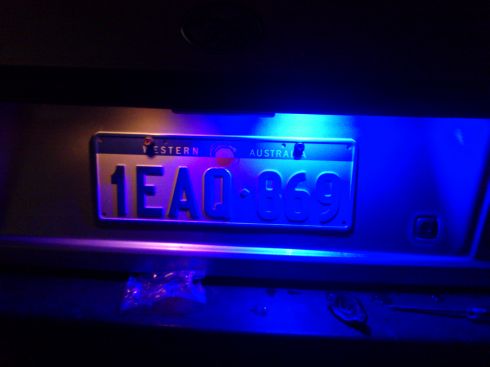

My T10 led wedges (Blue) arrived today I first placed them in the park light housing but they were too blue (looked ultra cool though) and then I placed them in my tailgate as number plate lights, again too blue, leaving them in would have had a flashing blue light behind me.
Looking at a light purple for the front parkers and 5050 smd white for the plate number.
Will place some pics of the blue on front and rear, BTW the blue T10 wedges are free to a good home.

Just fitted the new (White) 5050 smd T10 wedges to the parkers and they seem ok, they have a purple tinge to them but that is what I was looking for anyway.
Bad news on the indicators, the T10 wedges are longer than the standard bulb and will not fit inside the front indicator housing, so this rules out the LED conversion on the front indicators (for now).
Will take some photos tonight of the front parkers, BTW I have just bought another 4 White 5050 smd wedges for $3.60 which comes with free postage from an Aussie seller, getting the bling without the ca ching.
Cheers WayneO
Cheers WayneO
