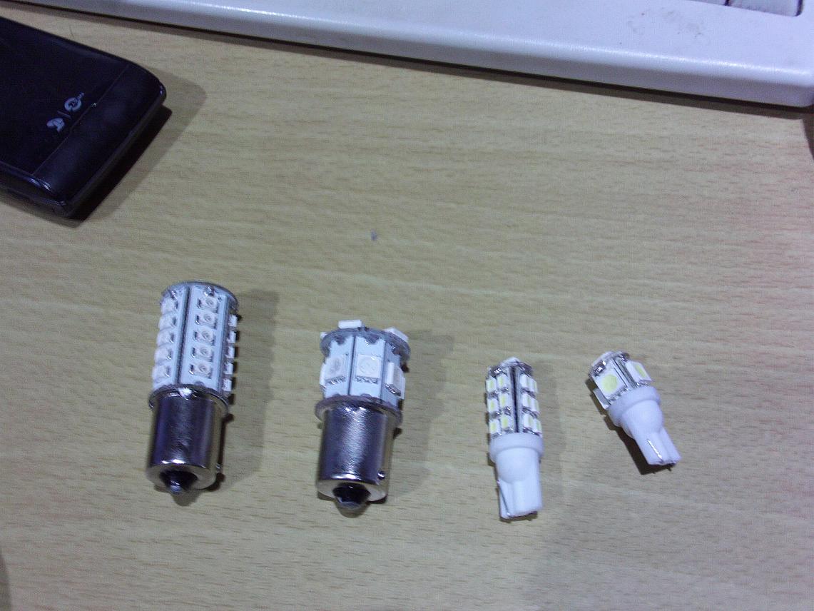

Post by Gannon » Tue May 15, 2012 7:33 pm
Ok from the left we have...
Amber 30x 3528 SMD - 270mA x 12v = 3.2W
Amber 13x 5050 SMD - 190mA x 12v = 2.3W
White 28x 3528 SMD - 200mA x 12v = 2.4W
White 5x 5050 SMD - 41mA x 12v = 0.5W
The amber LEDs are not quite as bright as a 21w amber incandescent globe, and these are over driven because their use is intermittent.
The first white LED is overdriven to the point where after about 5 minutes the light tints blue and is almost too hot to handle, obviously a bad design, but very bright. I had these installed and pulled them out because I doubted their life expectancy
The last white light is what I currently have in my car as my parkers and as you can see draws half a watt and is still brighter than the T10 incandescent globe
Also note that these readings include the power used by the internal current limiting resistors
I have some warm white versions of the last one on order so they match the yellowish colour of my headlights and I will post my results when I get them
