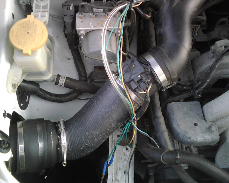

What model snorkel is that, and what mods did you need to do to make it fit? More info on that pls.

It's a Safari Snorkel for a Toyota Prado 120. Removed the airbox, added a custom piece of connector tubing to tie in the MAF and made a two stage filter at the top of the snorkel from a fine mesh pre-filter and 3M coarse grain padding. The filter setup works remarkably well and the car seems to have a bit more power without the restriction of the stock airbox and panel filter.
Will need to craft a temporary duty inline filter for use when I have the pre-filter installed for really dusty conditions.
