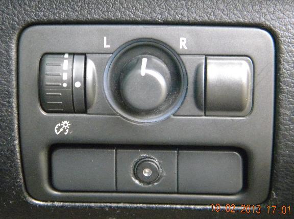

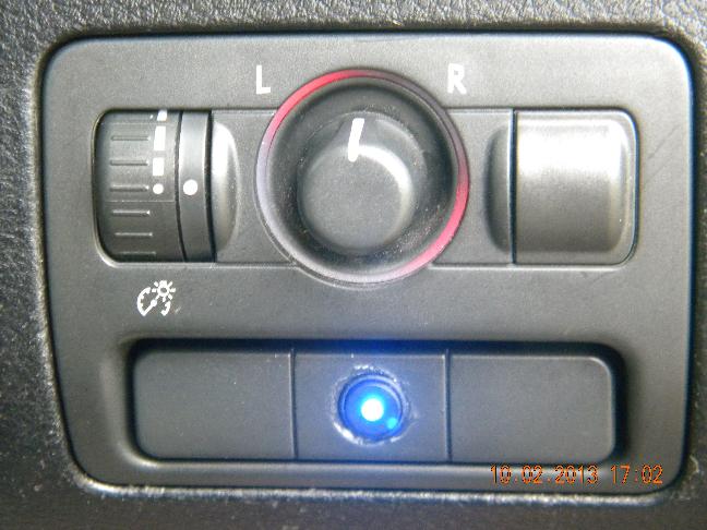

I have wired as your circuit and all is well. Since I don't like ugly switches hanging out of my dash I have used a tiny tact switch with an electronic latching circuit. This meant installing a second relay to switch the 12v to the first.
lights on.jpg (49.73 KiB) Viewed 6508 times
lights off.jpg (42.8 KiB) Viewed 6510 times
