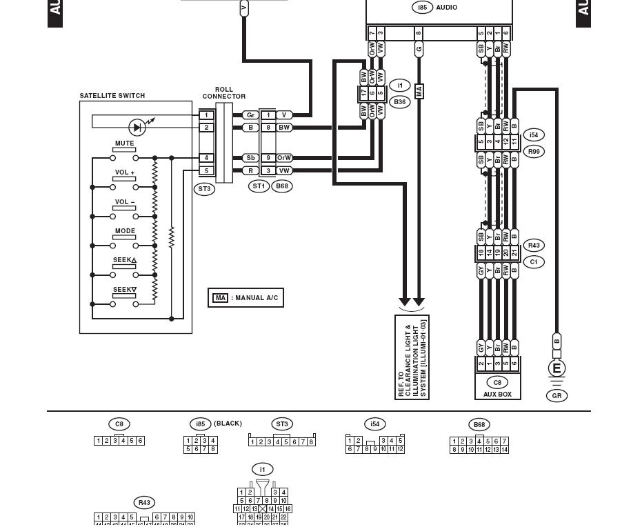

So did you install just the buttons to your steering wheel, or a new steering wheel?
Does the clock wheel behind the steering wheel have the required contacts for your new wheel?
Here is an image from the 2008 Legacy FSM showing the Roll Connector/Clockwheel connections
As you can see, the steering wheel controls plug into the steering wheel with a flat 8 pin connector (ST3) and then the roll connector joins into the dash wiring loom with a 2 row 14 pin connector (B68 )
Check to see if you have these

No just installed the control parts into my steering wheel , plugged the harness back it the the plug and crossed my fingers , from reading another forum my car my08 should have just been a case of plug and play , which has not been the case ,now I need to find a way to get it to work ,each time I look at it , the steering wheel ,I see a simple mod that I've failed at. I just need to find someone who know what their doing to see if it's possible to get it to work, somehow ,someway, you know of anyone ????
Ho and thanks for your posting I'll put those wiring diagrams to good use
I can design build and install a kitchen ,entertainment unit etc etc but understanding that wiring diagram, no way, its just lines going everywhere ,so again any help ,know someone who has done it ,can do it ,might be able to do it around sydney please send that info my way
