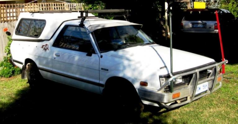

What has happened is that when headlights are on and switched to high beam, after about 1 minute the lights go out but if I switch back to low I still have low operating this happened a few times and now I just have low and no high when switched the prince of darknes strikes.
I've taken the lights out and checked them all and they work, I've removed and replaced all the earth connections I can locate but still to no avail.
My thoughts are perhaps it is in the combination turn and dipper switch on the steering column.
Oh my Brumby is a 92 quad headlight model with what appears to be H4 in the high/low outer and H1 in the inner high beam.
Hylton :twisted:
