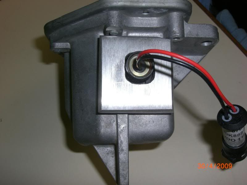

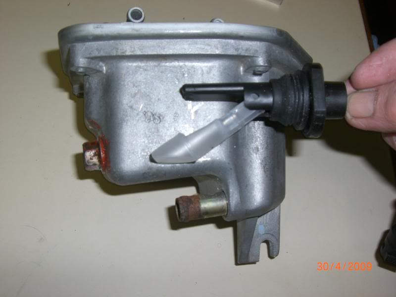

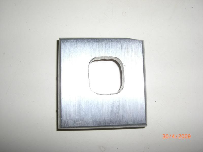

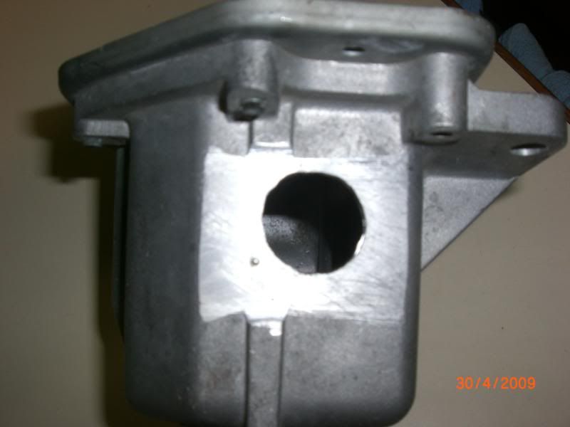

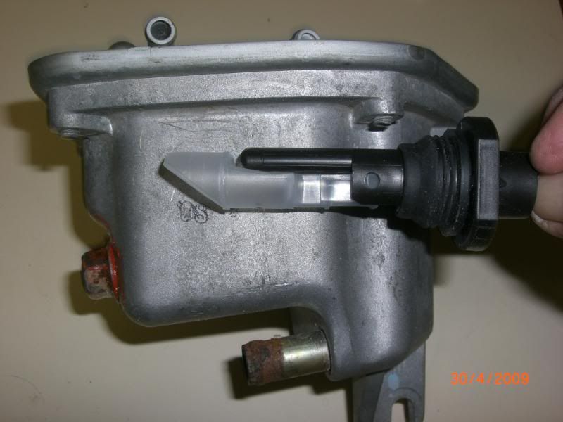

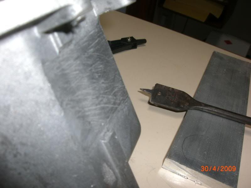

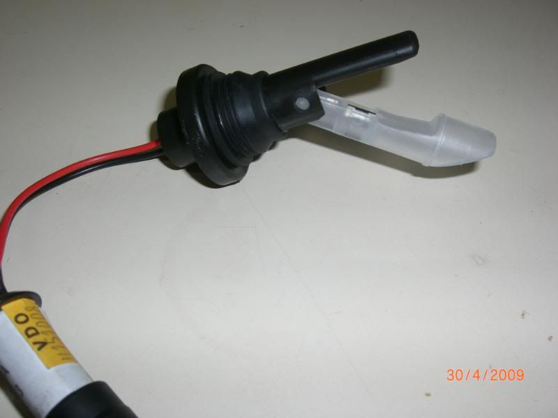

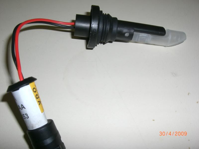

Here was my solution, I bought the low water sensor from a Falcon ($47) and modded a turbo header tank for it to fit (both my cars are turbo) unfortunately we couldn't work out how to power it, 12v= no good, relay= no good, LED light I think sort of worked so the idea was good but that's as far as it got...........I MUST finish it as I've already lost one motor because of a snapped hose.
We (the auto sparky & I) cut the plug off and tried most things to no avail, I guess it could be adapted to a radiator or overflow bottle if you could work out how it worked...looks simple but?????
The unit, as you can see once the float drops it bridges the power....if you can work that bit out lol,
Filed flat ready for drilling
Drilled
Cap which was later drilled to hold it in place.
You can see how it would work on low water
Drilled
