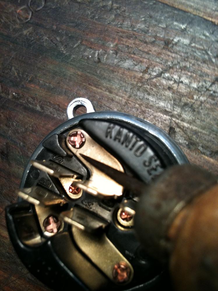

My no2 MV/Brumby truck Scruffy decided not to run once fired up....let go of the key and when it returns to run position (from the start position) the engine just cut out...puzzling.
Anyhowz I just happened to have a spare steering column complete with full ignition switch assembly on it.
I removed the electrical contact switch from the back and had a look at the terminals only to find under close inspection - a hair line crack on the brass pin that's for the starter motor power.
I showed this to my father (who is a lifelong and very experienced electrical engineer) he explained that the crack would mean a loss of grip to the copper stud which is molded into the body of the switch.
This loss of grip would be critical to the connection / circuit.
He got out his soldering gear and whilst I removed the 'offending' switch from Scruffy he made good the crack by doing a careful soldering job to the spare switch.
removing the underdash panel only, I then dropped the steering column by the 2 bolts to gain sufficient room to get in behind the switch to remove the 2 small retaining screws so quite quick and easy to get to the offending switch.
I swapped over the parts and re- assembled.
Scruffy lit up straight away and settled down to tick over as if there had never been a problem.
The switch from scruffy was also cracked exactly the same so a repair was immediately effected to this switch.The reason for a second repair being my no1 Truck tended to want the ignition key to be really pressed over hard to initiate it to fire up.
5 minutes later the repaired switch was in the no1 Truck and ...... I now only have to touch the key and the engine fires up immediately!
It seems to be far more willing to start......
I suspect that this is a common fault and that the terminal that cracks is always the same one that takes the pressure from the action of the key pressing against it.
Soldering the connection back is a easy and solid fix and should save cash by you not having to replace or even contemplate a starter button.
Have a look at the image and look close and you can just see the offending hairline crack that has caused the problem.
I'll post up the image of the reparied one so as Dad's done it for me.
Hope this helps !

hi Giles the pic is back of ignition ? from time to time my brumby wont start , let go of key tern again and of it goes didn't know why this may be what is wrong thanks

uCb wrote:hi Giles the pic is back of ignition ? from time to time my brumby wont start , let go of key tern again and of it goes didn't know why this may be what is wrong thanks
Yes it is the back - and its the electrical switch part that can be unscrewed from the key/lock front end.
Dad informs that if there were to be any crack then 12v will not gap across. Even a hair line crack.
Probably accounts for the reason why I have had to press the key hard to (make the gap up) to get the engine to turn.

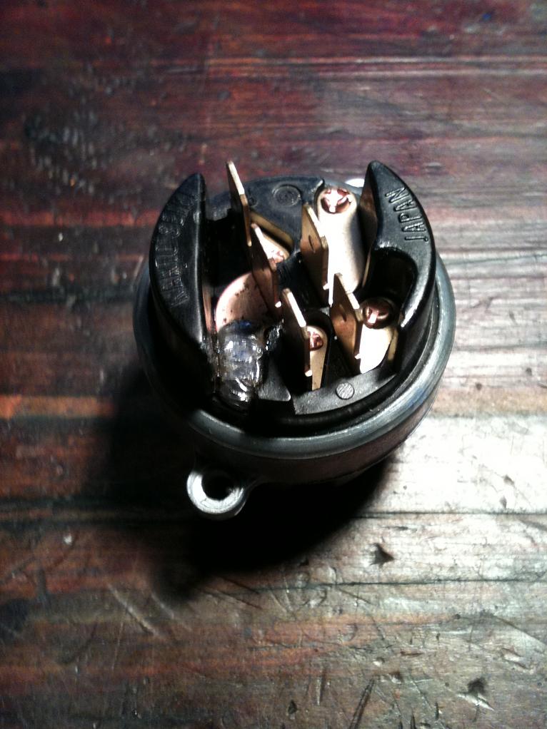

Here is an image of my spare ignition switch - now repaired.
