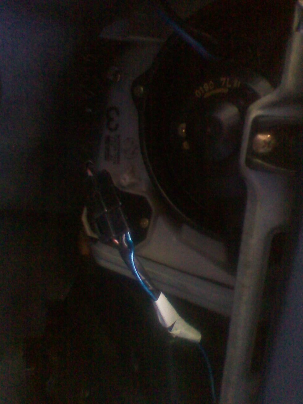

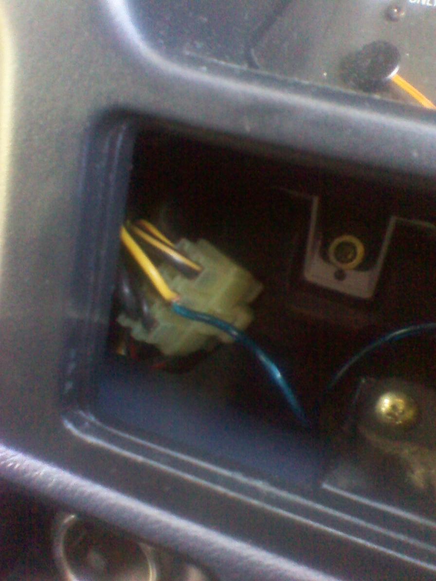

ok guys! this what i have done to work my heater!!!!
i ran a blue wire conecting from a b/wite wire from the fan then ran it to a sepret fuse, then to a y/green wire inside the removerble panal as show in photo
is the new wire i ran ok?:roll:

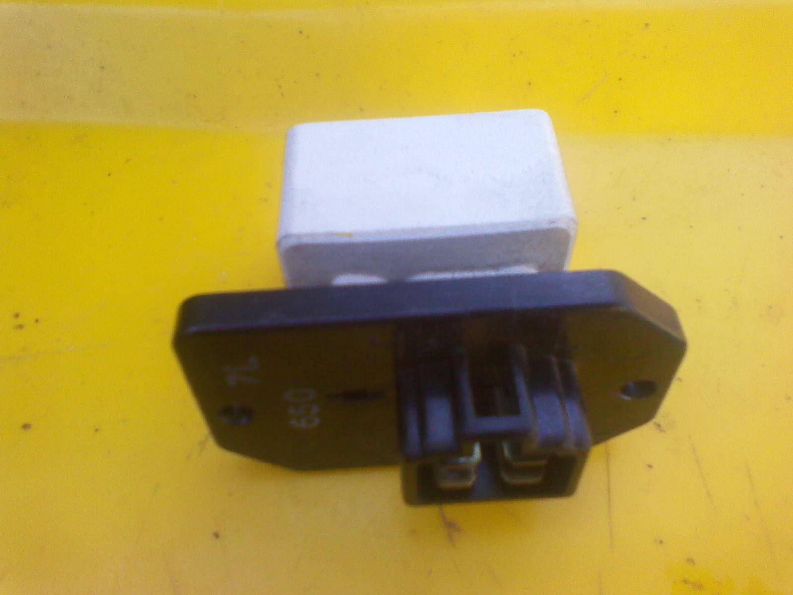

cool! thanx justin.. is this the fan speed resister? theres a wite cover on it an i cant see any coils
if it is! how much you reken that part will cost? (cant get to an auto place untill tomorrow some time)

Post by justin35 » Tue Jun 08, 2010 3:08 pm
that looks like the culprit ,replace that and you should be in business again
