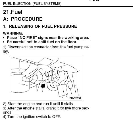

The fuel pump relay appears to be near the blower motor in the passenger side footwell
Unplug it and start the engine as described
- fuel relay.JPG (35.29 KiB) Viewed 2079 times
