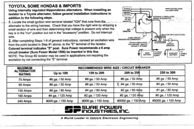

Ive checked out these redarc solenoids on line. Here is what I use. http://www.ase-supply.com/Battery_Isola ... _s/153.htm
Pretty good value and mine has lasted 6 years so far. I use Anderson sb50 connectors and a circuit breaker. I charge 2 deep cycle 6v golf cart batteries that run a 2000w intermittant, 1000w continuous invertor, which is fused additionally with a buss ann-150 fuse. Wiring is alternator specific and this example is the configuration I use.
[ATTACH]1830[/ATTACH]
- scan0016.jpg (71.15 KiB) Viewed 3434 times
