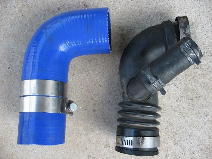

just pulled the EJ20 motor and i will need a new intake pipe from the turbo to the intercooler...........i'm running a liberty water/air intercooler and need this pipe in an upgraded material/strength as 29psi has blown the standard one.
anyone know where to source a newie, a web site or "good" ,lol, ebayer......any ideas on this problem appreciated

Hey Damien, i was just writing you an email with some info about that pipe.
This is the cheapest way to replace that hose. Costs around $40
It comprises of a bend and a straight piece of silicone, a short length of steel pipe and hoseclamps to join them
I bought my silicone from http://www.enthaily.com/welcome/page42.php

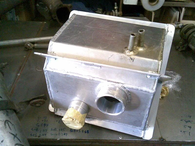

These are supposed to be good, but a little pricey.
PWR Water to Air Barrel Intercooler
Im sure Jeff has the skills to fabricate something similar

these the ones to upgrade to?

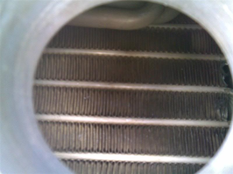

With the amount of airflow at 29psi, the liberty WAIC (which only has a 2" inlet) is going to be imparting a bit of a restriction and costing you HP

ended up finding a samco hose over here...........
http://rallynuts.com/motorsport/SAMCO_H ... )_1460.asp

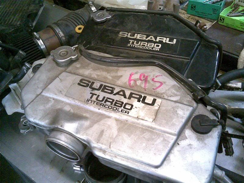

looking through the spares, i imagine this silver intercooler is same specs as the black one, just different model?..........
still tossing up on wether to go to bigger, custom waic........

The silver waic is from the Jap spec RS Legacy. I dunno if it has any performance gains, but it appears to have some kind of sensor, most likely a temperature sensor.

Be cool, go the bigger, custom waic!

can't complain about the service from "rallynuts".............7 days and it's sitting here ready to go......pics later.

the turbo to IC pipe was sorted.............

the standard liberty pipe from turbo to intercooler was long since blown apart, repaired track side, but never replaced. there was no way i could leave it. so a few options were sorted, as it's nice to arrive at race meets far from home with spares at hand...........
to avoid reinventing the wheel at this point, it has gone back together as it was previosly run. the samco model specific hose (wrx) will allow the use of standard recirulatory style blow off valve.

No bolt on turbo for a subaru is going to be any use at 29psi. Looks like you have an MY01 engine but I can't make out the turbo. Looks like a VFxx from the actuator though. Depending on the exhaust housing size it will only be good for 23psi at most, that's for the biggest nugget(VF22). All you will be doing at 29psi is churning up heat and damaging the turbo(and inevitably engine) for no reason. You will make more power at the turbos efficiency peak which will be 18-23psi depending on the specific trim of the turbo.
This is just FYI, I am not trying to attack you or anything.
I'm sure the car is devestatingly fast anyway but pumping boost in does not equal more power if it is out of efficiency.
The waic will really be struggling at anything above 15psi anyway, they are just not designed to flow that much air.
The silver and black cores are the same except for the water level sensor.
