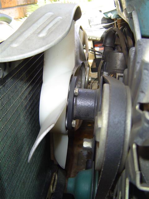

[ATTACH]530[/ATTACH]It's not a clutch fan, it's fixed!

EA81's are no ball of fire trust me , prove it to yourself by removing the fan and going for a short run . In factory form the US type EFI and turbo ones were as good as they got .

You can get a tensioner pulley from an EA81 that had air con so that it doesn't have the fan mount sticking out, other than that you just need to wire up the second fan, I would rewire it so that both fans run off a relay, I found that the standard wiring struggled with just one fan, running a second fan made them both run slowly and the wires VERY warm, using a relay made a significant improvement in the fan speed and temperature stability.
