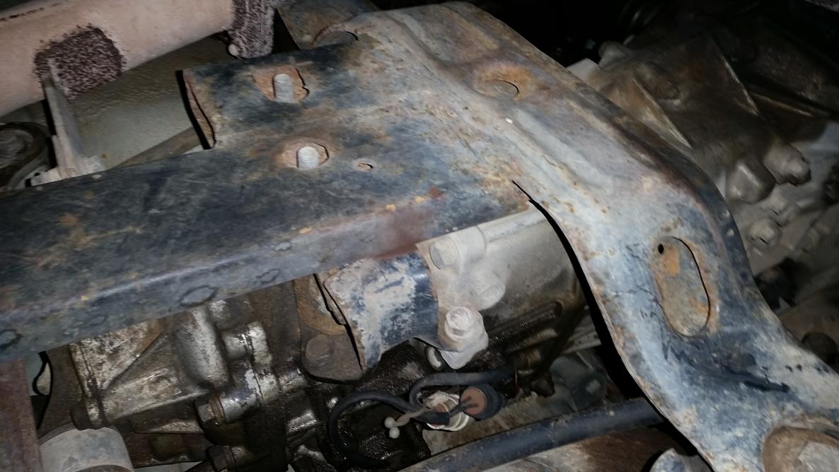

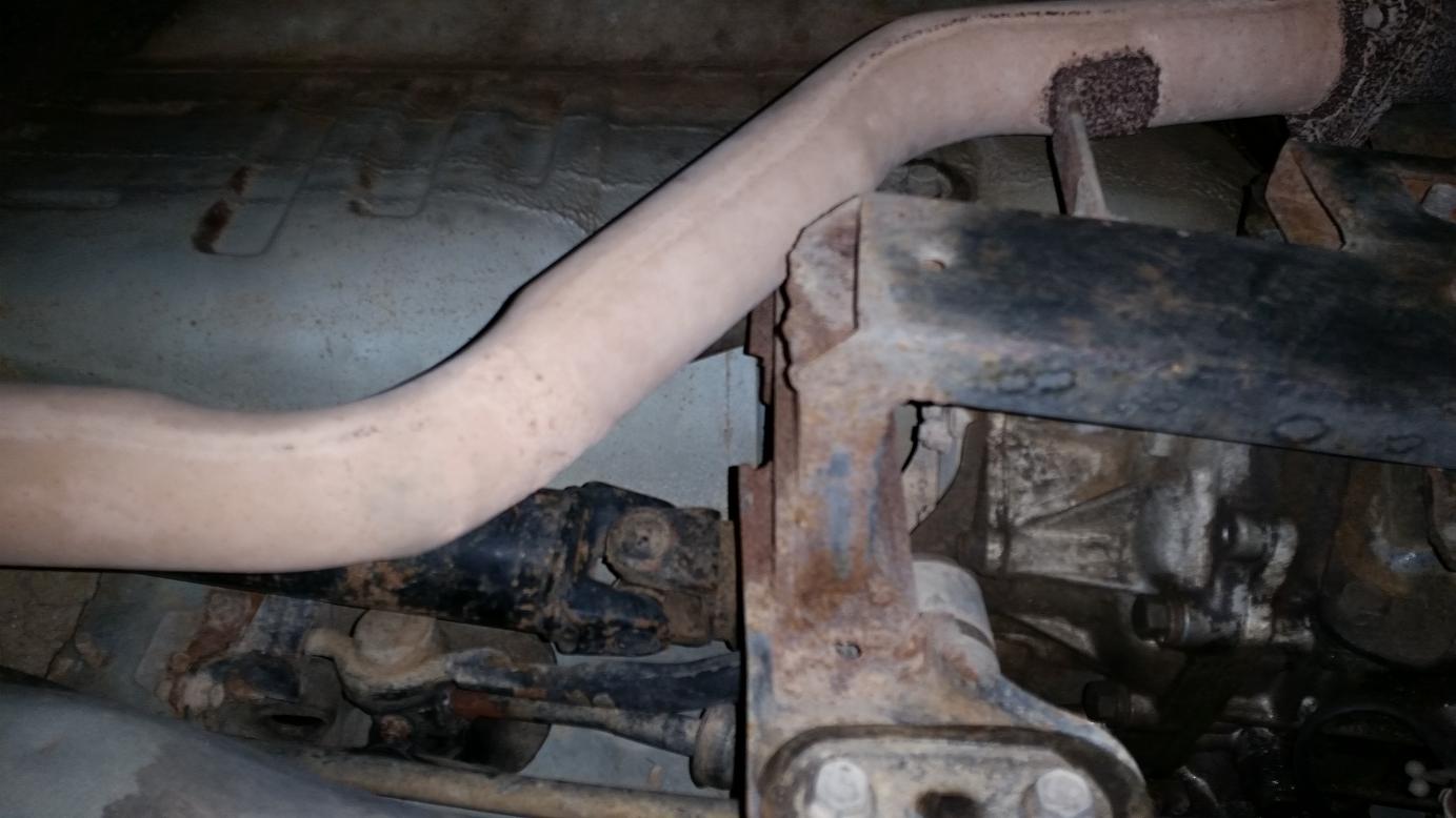

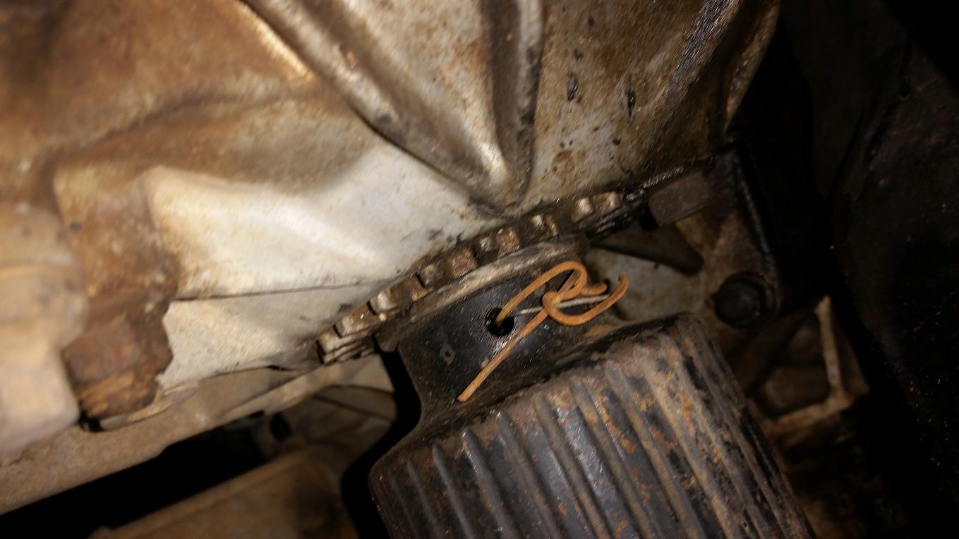

Post by Brumby_ProjectX » Wed May 13, 2015 7:18 pm
So here's a few photos on the quality workmanship... and a nice piece of wire through the cv... and thats just the start...

And yes that is a very agricultural gearbox mount. :)
