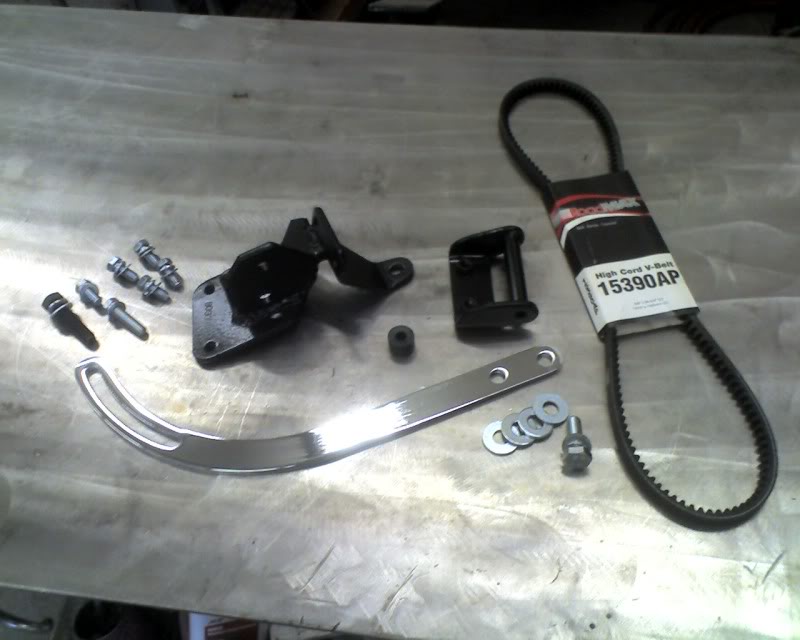

Back on topic for this thread here is a kit to mount an EA82 PS pump on to an EA 81 engine, You will note how similar it looks to the factory EA81 Turbo bracketry.
EA82 power steer pump to EA81 kit.jpg (55.79 KiB) Viewed 8134 times

coxy wrote:Back on topic for this thread here is a kit to mount an EA82 PS pump on to an EA 81 engine, You will note how similar it looks to the factory EA81 Turbo bracketry.
Very interesting stuff, they are probably a much easier pump to get parts for than the old my job.
Post by Silverbullet » Sun Dec 22, 2013 7:51 pm
^ Agreed, but by the looks of that custom bracketry you wouldn't be able to have a stock A/C setup :-?
Post by steptoe » Sun Dec 22, 2013 10:02 pm
Guess you could fit an EA82 to use its pump in the right place without coxys find :)
Post by Silverbullet » Sun Dec 22, 2013 10:29 pm
steptoe wrote:Guess you could fit an EA82 to use its pump in the right place without coxys find :)
EA82 in place of twin port? I think not!!! :o
