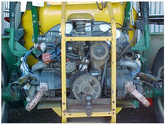

Tweety was taken for a run to Melbourne return. 2 hours one way. Planning for our round Oz trip next winter I'm thinking the exhaust is just that little loud. great at 80kph but after 2 hours at 100-110 kph it is a wee bit noisy.
No room for more mufflers or even the smallest hot dog. No cat. has joining tube.
What I was wodnering is whether steel tubes could be palced inside the 4 tailpipes. they are 1 3/4" pipes. and if the inner diameter is say 1 inch would it quieten it down?

I just went through 18 pages of Tweetys thread on his trike build to find the exhaust pictures
Im thinking small baffles in a 3 inch pipe could be used, where the final pipes come off the exhausts. it would mean you would lose about a foot of the original up pipes but the baffles will quiet down the rumble.
Hmmmm quietest ones available at the time the exhaust was built.Tweety wrote: See because of the need shortly of a noise level test (for engineer) and besides I like a reasonably quiet exhaust. I left it to the exhaust guys to choose the muffler and they tole me these were the quietest of the several they tried on the ends of those straight out pipes.

Scrub this solution...
I know this is very, very simple, perhaps too simple for the application and stupid for the engine's design/control systems/complexity. But...Tweety wrote:and there is the K.I.S.S principle.
...Some coarse steel wool (coarse scourer type) in the exhaust pipes can be effective. The simple application this was done to was a VW dune buggy with straight through exhaust pipes. It was fixed in place just inside the pipe ends with fencing wire crossed across the ends. It was just enough to smooth the exhaust flow hitting the atmosphere. A typical farmer's solution, on an old-style motor but surprisingly effective and it was a flat four...
You can just see the wires + steel wool in the attached pic.
