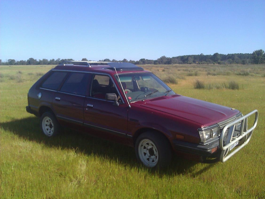

off topic, I had it up north in around AJS yesterday arvo, looking for some spots to launch our UAS's with some buddies. Man this little subie is good in soft sand!
Anyway, off to pull the scoobie apart.

- WP_000096.jpg (98.29 KiB) Viewed 5883 times
- Silverbullet
- Posts: 2953
- Location: Adelaide
Looks to be in great condition! With a sun roof as well. What does UAS stand for?
