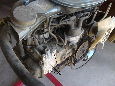

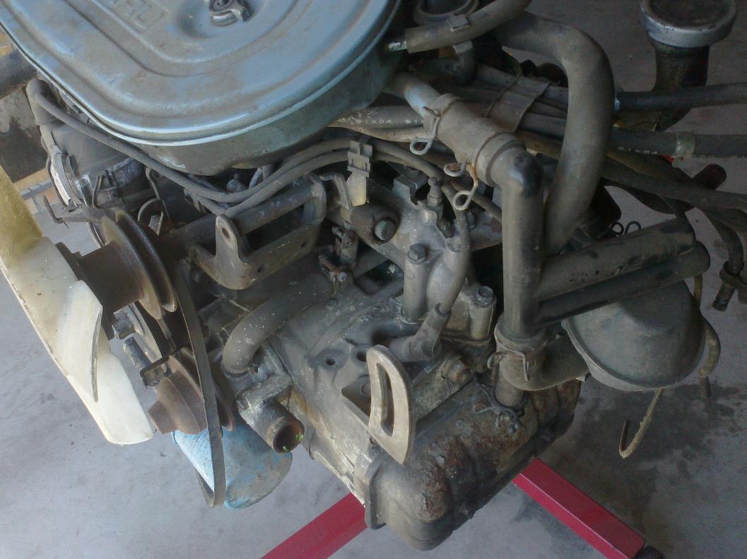

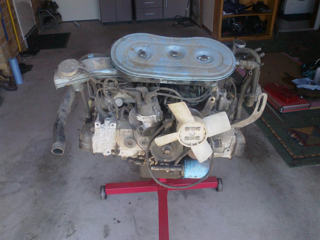

Ok, I need a new engine for my Brumby. I was just wondering if you think the engine i have is going to scrub up ok as it has been out in the weather and looks quite rough. Can it be soda/bead blasted to bring it back to it's original glory?
I was looking on ebay for a new block and there is one that says ea81 long motor and ea81 short motor - is there any difference if i was looking for a better ea81 to rebuild?
And are the three holes i have pointed to on the head where the power steering bolts up to?
What sort of things should i be buying? New cam, new pusrod, new valves, new hydraulic lifters??

Post by Silverbullet » Thu Oct 04, 2012 6:37 pm
Haha if you use my thread for guidance, just know that engine failed within 30 km's :-o I think because something wasn't torqued up to spec or there was some crud stuck in a oil gallery that got pushed into a main bearing. But that's another story.
Yes those 3 holes are for P/steering but you'll need the 3 groove crank pulley and a few other things if you want p/steer. If you can get that engine apart without breaking anything and there's no cracks or terrible corrosion inside, it will scrub up fine and with a bead blast and re-painted rocker covers and sump they look like new. Shouldn't need a new cam, if you're doing a proper rebuild you can get it re-ground. Pushrods should be fine, valves and seats can be re-cut but you should get the cylinders bored and or honed with new pistons and rings to suit as well as the obvious things like main and big end bearings, crank linish. On the other engine I got built it had solid lifters but they can be re-faced as well. Are EA81 hydraulic lifters still available???
That's about as far as my knowledge goes; there are others on here who know alot more than me. If littlewhiteute Gary pops in I'm sure he'll have some wise words.
Post by TOONGA » Thu Oct 04, 2012 6:48 pm
Does the crank in that engine rotate?
If it does, I'm betting it would start :)
Long motor = bare complete engine you must use all you accessories.
short motor = complete block, no heads (or it should be complete) your heads and pushrods and accessories.

Stick your engine in with rebuilder and let them advise you what they can do or need. I get mine to former glory visually with dremel style wire brush, wax and grease remover etc

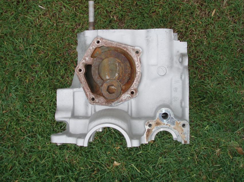

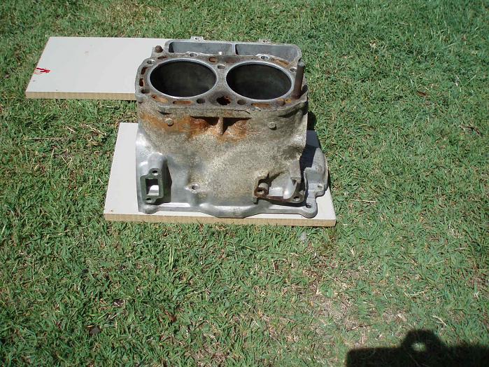

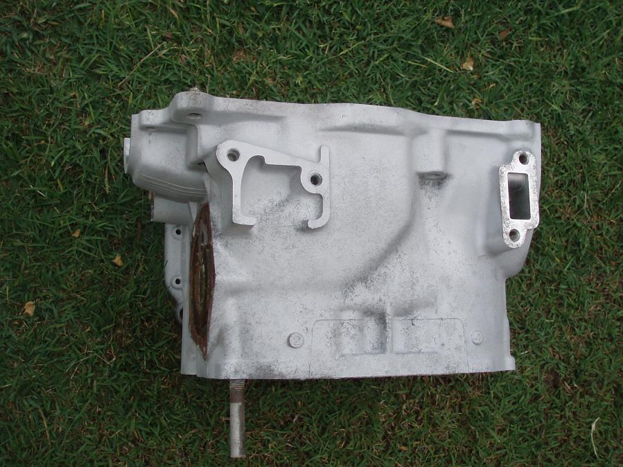

Ok, got another engine attached to a Brumby with Air Conditioning for $300. It's been a little drawn out with other things getting in the way, but, I have split the block, had the heads and block washed and acid bathed (got it for half price cause it didn't do much but took away all the grease and oil) and I'm now giving them a blast with glass in my recently acquired cabinet.
Came up pretty good but there is little black marks which Google tells me is carbon. Anyone got any brilliant ideas for getting rid of it? I also have a sheet of glass and wanted to sand the head and block faces - what grade of sand paper is used? Probably won't be able to do it on the block with half a stud sticking out - i had to strip a few threads to get some of the others out.
Last question for the minute - the temp sender in the inlet manifold stripped when i pulled it out - If i helicoil it - will the helicoil seal the water jacket or should I get another manifold?
Post by TOONGA » Fri Dec 28, 2012 3:41 pm
looking good when you said you had blasted the block and heads with glass beads, I thought you had done the pistons as well, I had to read it again.
Get another manifold but make sure your carby fits
I would go to the EA82 manifold like most of the Americans do. they are newer and have less porosity (from age) and are a bit bigger in the port areas you will need to modify a few things but from what Ive read it is worth it. sadly the link I had was on the hard drive that crashed :(
