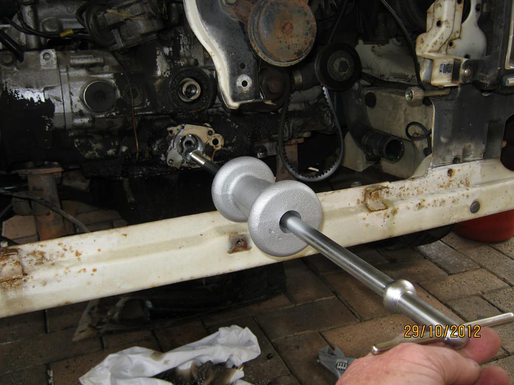

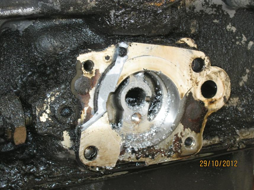

Look what can happen when some bone head uses sealant to seal the oil pump.
note housing has been drilled and taped for puller bolt, hence the alloy swarf, but take note of the broken housing.
Had to drill and tap a M6 hole and go buy a slide hammer $80 at Gasweld.
Took a bout 8 seconds to gently "pull" it out.
Nothing like the write tools for the job.
Luckly I dont do an oil pump without having another one ready to fit.
fitted an new front crank seal and pressure cleaned the front of the motor while it was easy to get at.
