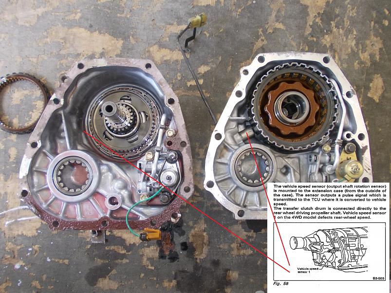

I'd have to pull the transfer housing off again to be sure but in the mean time I have just tried to count the teeth on the first picture I posted.Gannon wrote:Im betting the difference is in the toothed wheels as this will cause lockup the moment you start to move.
There is certainly 30 teeth on the MPT clutch basket and while I can't see the whole VTD wheel I have deduced that there are 50 inner teeth on the clutch plates and 6 outer teeth for every 10 inner teeth which also totals to 30.

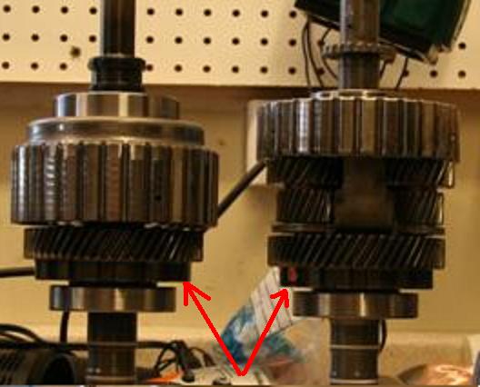

These are the tone rings you need to compare
The VTD seems to have more teeth

Sorry my mistake, the toothed ring I pointed to is the parking gear. I was looking at it upside down.

The speed sensor difference is also a problem. The sensor counts the outside drum of the clutch pack. 30 teeth in a MPT, and 22 in a VTD. When I ran a MPT TCU with a VTD rear end it always shifted a bit funny, and I blamed it on this. The WRX TCU is set up for this speed sensor, and shifts properly.
