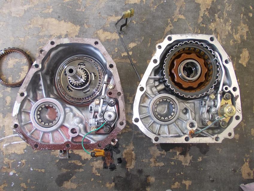

I was experiencing torque bind so went straight in for the Duty C solenoid and what I found was very surprising.
Please view the attached photo.
The extension housing on the left is from my car.
The one on the right is from the same model car.
Both are standard TZ102ZG1AA auto transmissions which match the compliance plate on the vehicle but that's where the similarity ends. They have a completely different MTP assembly. I can't even find rear transmission mounts to suit my car as the extension housing is also a different shape on the outside.
Every automatic first generation AWD Liberty I have looked has a MPT clutch and extension housing on the right. My suspicion is that the box on the left is from an imported vehicle maybe bought unknowingly from a wrecker or left over from a front cut?
I have tried to solve this problem myself and have had some of the best Subaru minds look at it. We are all stumped. Does anyone on this forum have a suggestion about what type of transmission I am looking at here or what vehicle it may have originally come from?
Thanks in advance, Scott.
- DSCN3731.jpg (113.2 KiB) Viewed 7669 times
Have you got more photos with the rear transfer units removed. The one on the left has a gear visible, if it makes up a planatery gearset, you have yourself a VTD or Variable Torque Distribution gearbox, or at least rear end. But to my knowledge, these didnt come out till the 2nd generation turbo models

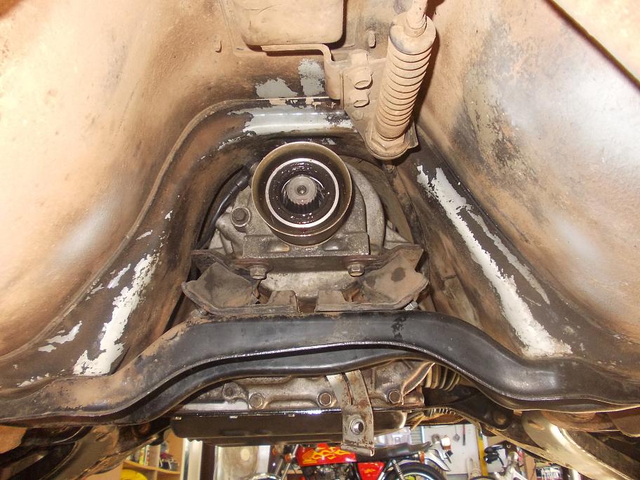

It's a shame I didn't take a photo of the rear end of the transmission with the extension housing removed. If I try to describe it I would say there is a clutch basket with three planetary gears visible behind still attached to the output shaft when the housing is taken off. That could be a match to what you are describing.
The only other photo I have is of the extension housing still in the vehicle.
If it is a VDT that could explain why I'm still getting torque to the rear with a full 12V on the duty C solenoid. From my brief reading they seem to be performance oriented with rear wheel torque bias.

This is a vtd diff
In open mode, it operates as a normal, open differential with a slightly biased torque split of 40 front /60 rear. When locked it gives a 50/50 split or the ECU can vary it anywhere in between.
But I cant remember if it is open or locked when the ECU is giving 100% +12v on duty C. I have a feeling its opposite to the normal multi plate transfer clutch which is why it should need the ECU to match.
The SVX would have been the only Australian delivered model to have VTD in this transmission because starting in Gen3, the auto box was updated and its a little different.
In the Gen3 Liberty, H6 Outbacks and B4 auto's as well as a few Heritage 2.5's optioned with VDC got VDC

Thanks mate, this is golden information and is starting to explain a lot of the unusual torque split behaviour I am getting from this transmission. I am still getting some rear wheel drive with the FWD fuse installed.
Almost certainly someone has put a Australian Delivered SVX transmission or perhaps an imported Automatic RS turbo transmission into my car. I can't confirm if the TCU was also swapped but I have studied the TCU wiring diagrams of both models and all the inputs and outputs match even though the colour coding is different.
