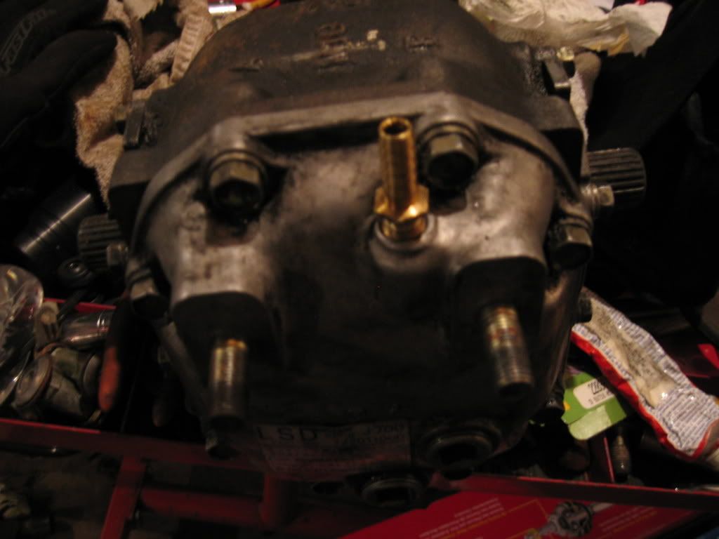

I'd say that he is - from his description you slide it in the breather's hole with some sealant around it. I've used a plastic one from bunnings that's meant for sprinkler systems, shave one barb off and shove it in, nice and tight fit.purp wrote:Hey tambox, are you talking something like this?
Is the hole that the existing breather sits in threaded, or is it just about the right size?

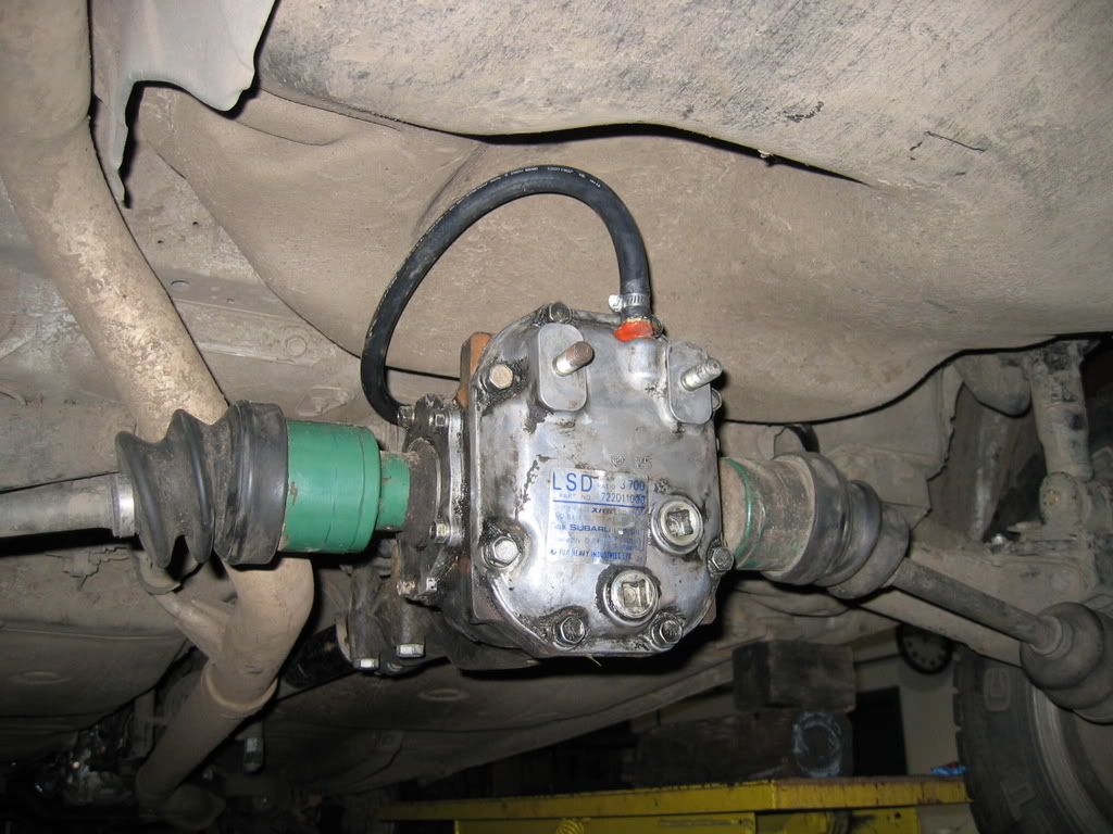

I just found this while looking for another image. Moustache bar is missing so you can see what's been done:
I also like the way he's "lifted" the rear shock/strut ^ If anyone know's their early subaru rear ends will see that the lower mounting point for the shock/strut has been raised.
from this fella's photobucket account
