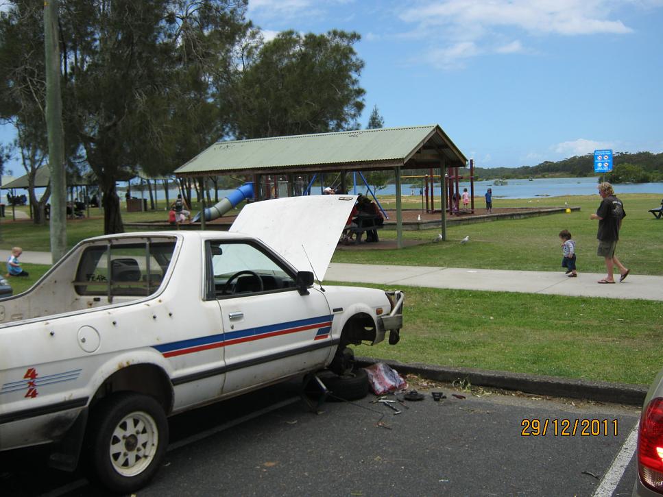

Drive it to a car park for a play park near the Golf course at Nambucca and fitted another hub. Drove it home to coffs 2wd no probs.

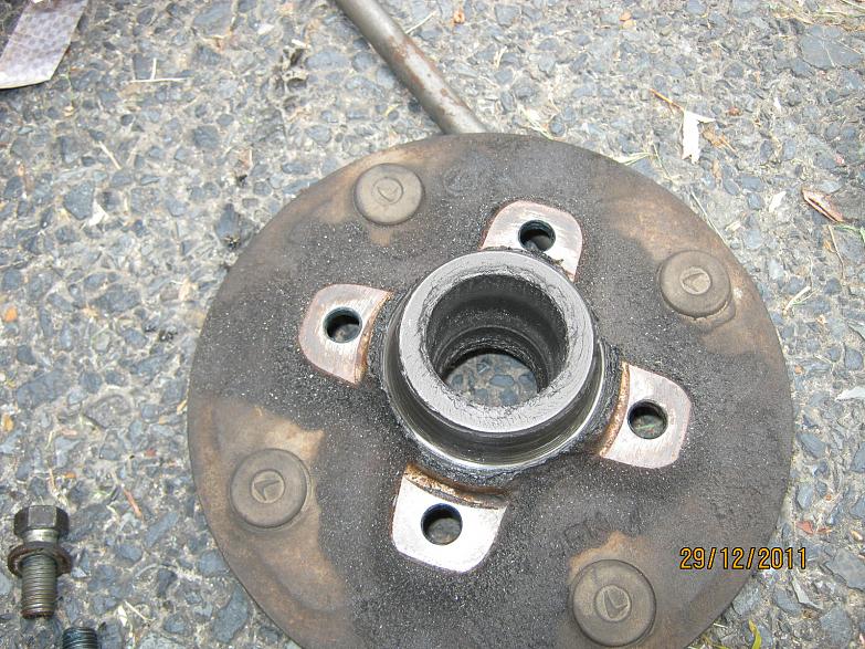

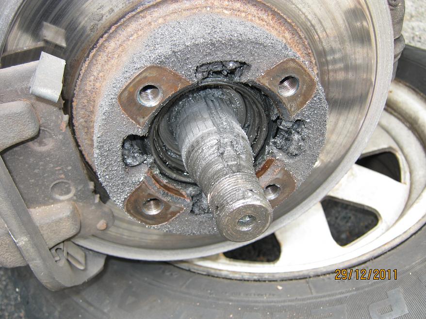

- IMG_0109.jpg (103.52 KiB) Viewed 2448 times
- IMG_0108.jpg (119.3 KiB) Viewed 2442 times
- IMG_0107.jpg (113.58 KiB) Viewed 2443 times
Great to hear.. glad you had the parts ready to fix
Love the roadside repairs.. RAC will be upset
Oh i'm fixen her up but not for the "on" road. Still working on her right now.
