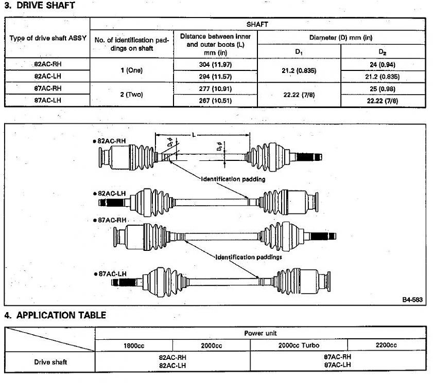

Taken from the BC/BF Gen1 Liberty FSM
Why is the right hand side shaft 10mm longer and 2.8mm larger in diameter at one end, compared to the left side?
Also, why is the 2.0 turbo and 2.2L shafts 27mm shorter than the 1.8 and 2.0L non turbo?
The track should be the same, as should the width of the gearbox. Why the difference?
ej shafts.jpg (98.67 KiB) Viewed 2520 times
Post by steptoe » Tue Sep 20, 2011 8:32 am
Maybe the DOJ and CVJ are longer?

The lower spec models ran skinnier tyres and had the track width increased by 10mm so that the outside edge of the tyres remained in the same position.
Std tyres were 185, tyres for the 1.6, 1.8 and 2.0 (non-turbo) were 165 or 175. so that accounts for the 10mm difference on the 175 tyres.
On the 165 tyres (1.6l models) they changed the offset of the rim to +50 from +55 to gain an extra 5mm of width - I guess they decided to live with these models being 10mm narrower.
Why they didn't leave the drive shafts the same and do it all with a different offset rims I have no idea.
All this info was taken from the same service manual as the original post.

Gannon wrote:So is the track width difference in the lower control arms, or the actual hub?
I would guess neither. The drive shaft being longer would push the hub out and I assume the ball joints and rubber strut top mounts would take up the difference ? maybe the camber bolt helps as well ?

it,d be slight difference in lower control arm and slight camber bolt adjustment
