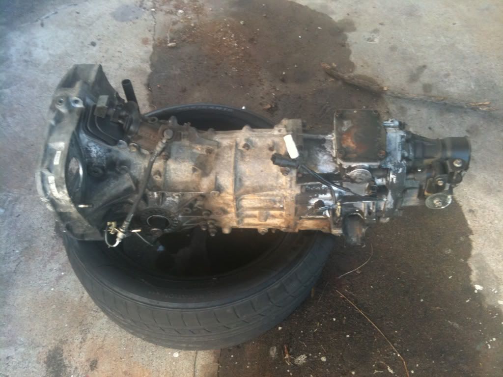

so this afternoon i dismantled it.
not really difficult, i just needed to punch out the dowls.
the box

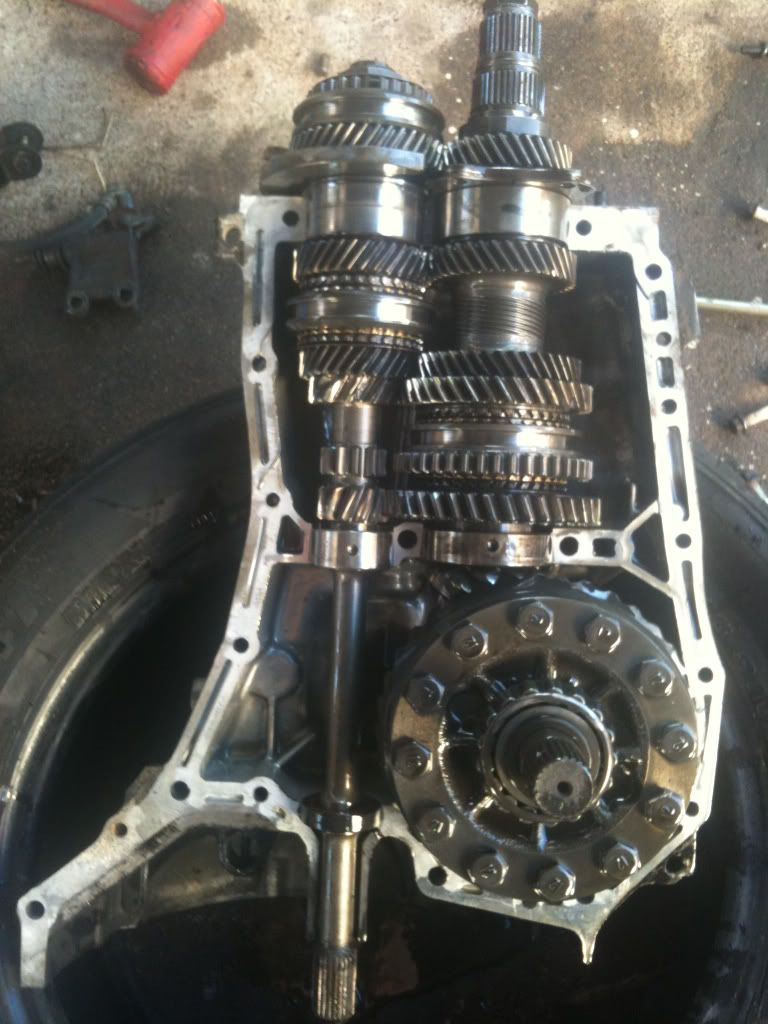

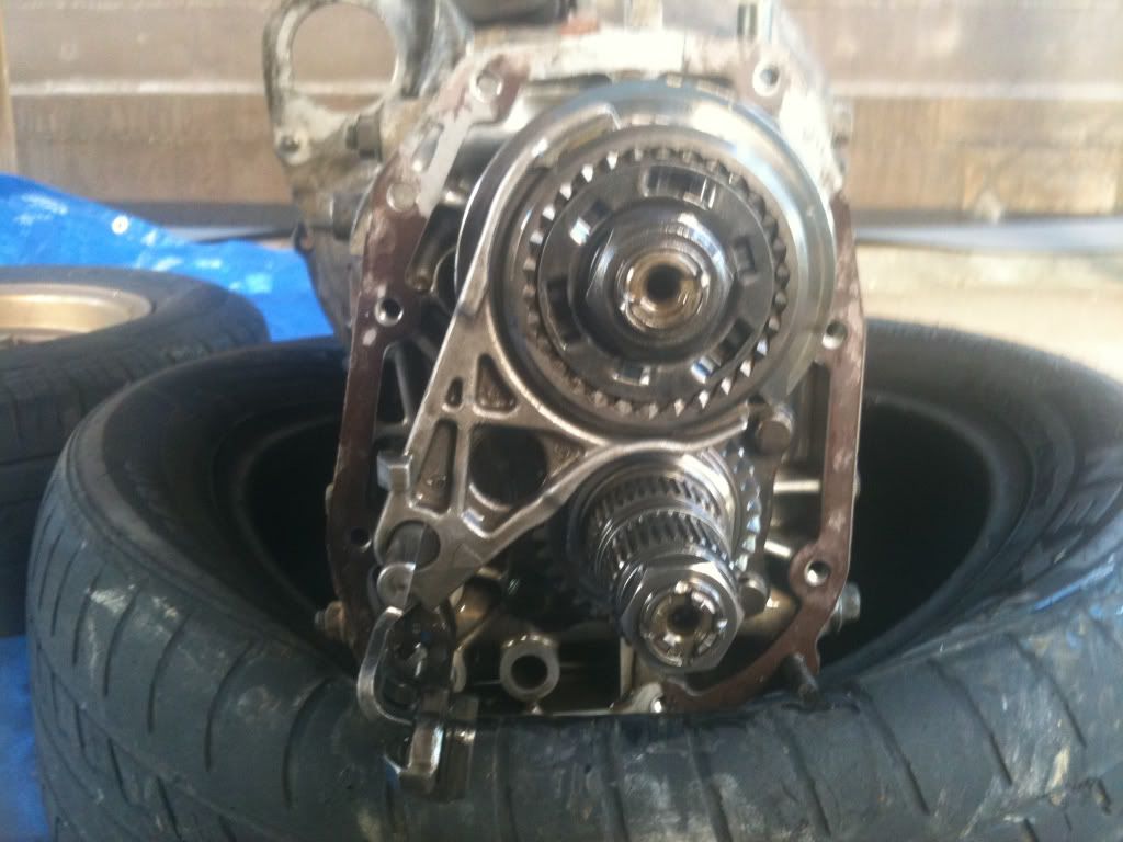

rear case seperation

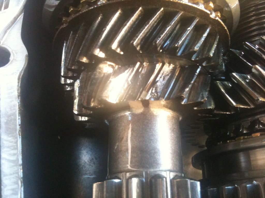

broken second gear teeth on main shaft
besides that, its fine, only needs 2nd and 5th gear synchro
and a set of bearings.
