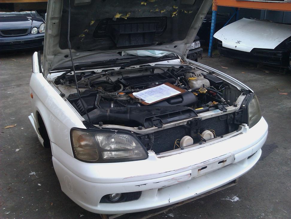

So i just bought a jap gt-b twin turbo automatic halfcut, does anyone have a list of front diff ratios for these cars because I don't know what ratio it has and i've search for ages and can't find a definate answer?

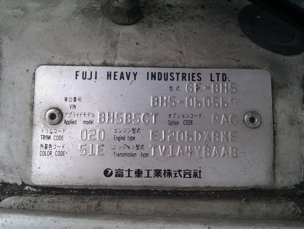

Here is the build plate, a quick search tells me that this halfcut started life as a gt-b wagon e-tune. Its going to find a new home in a 3gen outback.

From your ID tag...
B = Legacy/Liberty
H = Wagon
5 = 2.0 ltr (EJ20)
TV1A4YBAAB = Trip Tronic auto (B4)
Did you get the rear diff with your 1/2 cut?

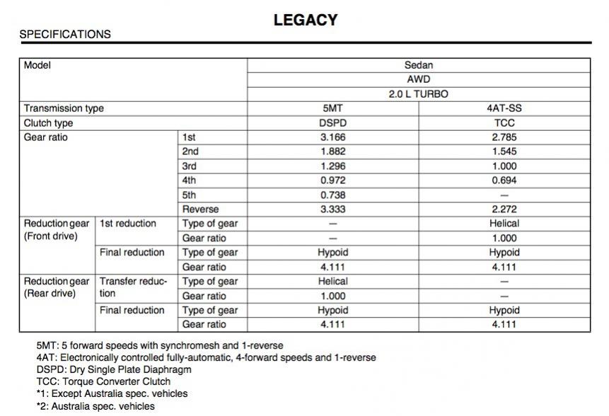

just been looking at the '03 legacy FSM, it reckons the turbo automatic diff ratio is 4.11... My outback is a 4.44 and I need to figure it out 100% cos I can't afford to have the car undrivable while I chase up the correct diff...
Any thoughts as to what diff is in my halfcut?
Post by TOONGA » Sat Mar 19, 2011 3:32 pm
a quick question
is the FSM for the American Legacy or the Japanese Legacy?
American delivered Legacy has a different ratio to the JDM Legacy (as far as I know)

hmm good question, I can't see anywhere where it specifies what region. It covers both RHD and LHD, and at times it references specifically to different regions (for example has an asterisk for australia only models in the above pic), so I think it is a generic all-region manual... It is for MY03 vehicles, maybe they changed ratios for the later revision cars? I don't know what year my halfcut is, but its a rev A, so it must be an earlier model. I found FSM's for 99 and 00 legacy's but they don't cover the turbo engine models.
