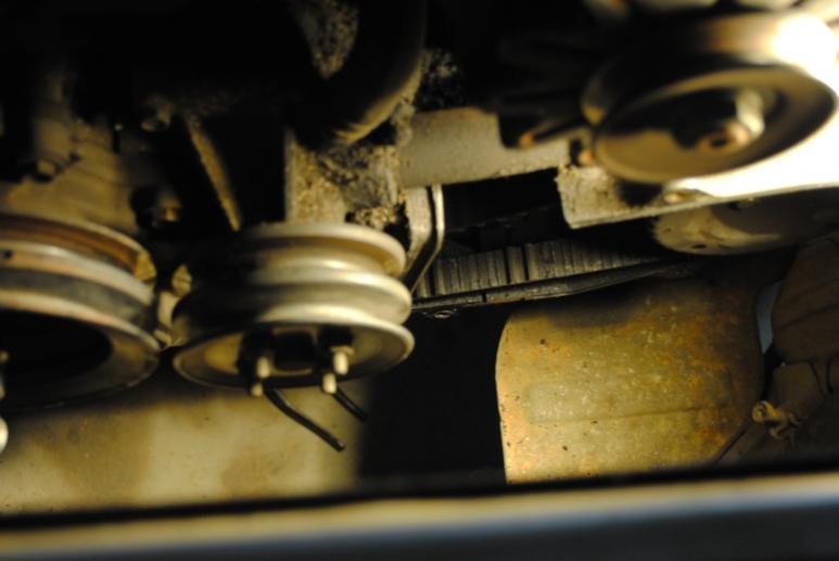

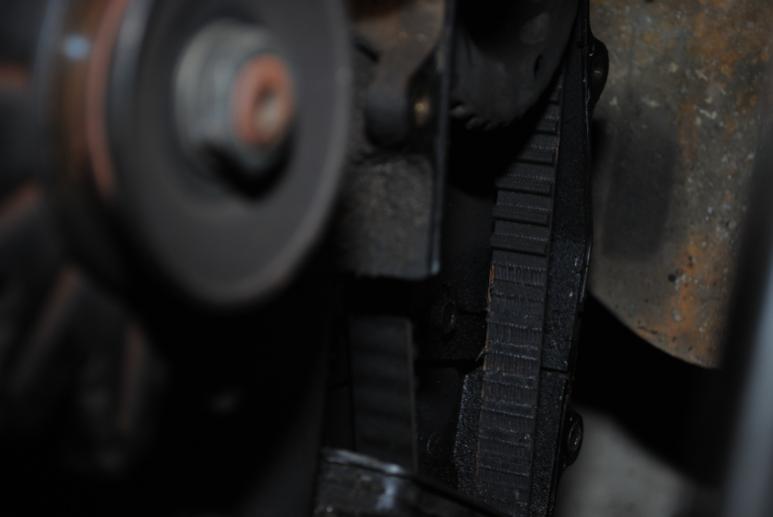

Problem identified.
Hello,
Thanks for your help thus far.
I inspected the timing belt last night, and the LH belt has localised tooth destruction. (see picture)
I checked out the cam, and the gear on that is fine, I'm presume that once the dissy ceased, the cam shaft did as well -causing the belt to strip out.
I got a dissy from a wreckers and will get timing belts tonight.
Any hints on their replacement, i.e. radiator out, engine out? or is it prefereable to do it all in situ?

Radiators and their fans out is best - gives more room and reduces risk of damage to them so long as you store safely away.
Have you got a manual that describes the replacement of these belts? On first look I needed to reread a few times as there are mraks on flywheel that are cam belt install marks NOT ignition timing marks. There is three marks together about 3mm apart. Also the marker on back of timing belt back plates and marks on cam wheel.
Commonsense shows dizzy belt first (from memory) when it is on and tension good, a full rotate once of crank to line up same middle mark to then install turbo side belt (non dizzy side for those without hair dryer)
Natty design is that oil pump and dizzy run off same belt
